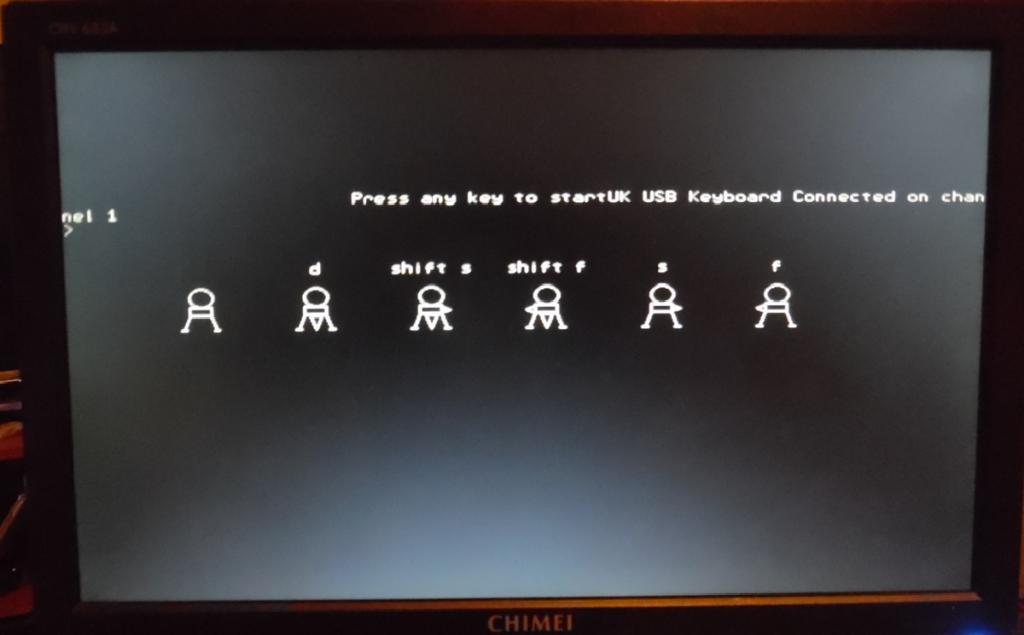

hi. if I power up vga usb and autorun on then prog starts, cls.. prints message but then message about keyboard gets printed.
a pause needed in user code or in firmware?

Hi Mick, simple code but only power up autorun prob. code "works" when a key pressed.
if autorun off then just uk kb message until I reflash from win mmedit pc or mmcc or type on pico usb kb.

The USB message would normally be sent to the console. If you are using a VGA monitor then I wouldn't expect to see this unless you were using OPTION LCDPANEL CONSOLE. Try entering OPTION LCDPANEL NOCONSOLE at the prompt and see if that works.

nocosole worked. I don't remember setting it on, messing with lcd terminal.
mmcc different and nothing on the vga I didn't put there. control c stops code but no >
