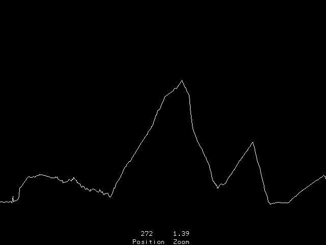

I've been messing with moonscape data from the original 1973 LUNARLANDER by Jack Burness.
Visit here for more information.
With much array manipulation, I've got the following demo working for the PicoMiteVGA. This uses a Wii controller to zoom and shift the terrain. (Right joystick up/down for zoom, left joystick left and right.)
PicoLander02.zip
Posts: 6192
Posted: 04:52pm 10 Mar 2024
Hi Pete,
Works nice... You can zoom and scroll with the controller.
