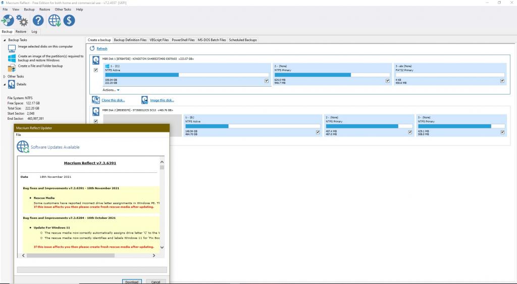

I used macrium but now said it's not free what to do , keep as is?. my version on win10
