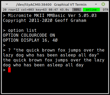

as far as i can tell, the mx170 verison of mmbasic does not suffer from this limitation:
Micromite MKII MMBasic Ver 5.05.03
Copyright 2011-2020 Geoff Graham
> option display 20, 40
> ? "the quick brown fox jumps over the lazy dog who is asleep all day long"
rob  :-)

not quite sure what planet you are living on Peter, but the mx170 only supports console mode; all interaction is via a serial console. here is a screen capture:
as you can see, the command line wraps but is still interpreted correctly when the enter key is pressed.
rob   :-)
