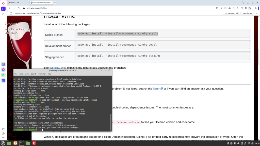

So, I tried to MANUALLY do it, using the WINE HQ instructions, but it fell over and died when I tried to actually install WINE:
The instructions I was following was from this link.
All went fine, up until I tried to actually install WINE.

Can anyone help with what Linux is moaning about in the screenshot above, cos I don't even understand what the problem is - "You have held broken packages."....
WTF does that mean?!

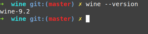

I'm using Linux Mint 21.3 and Wine 9.

I think your error is related to using the incorrect Debian repo, which has libraries in a version not supported by your Linux Mint.
You can try:

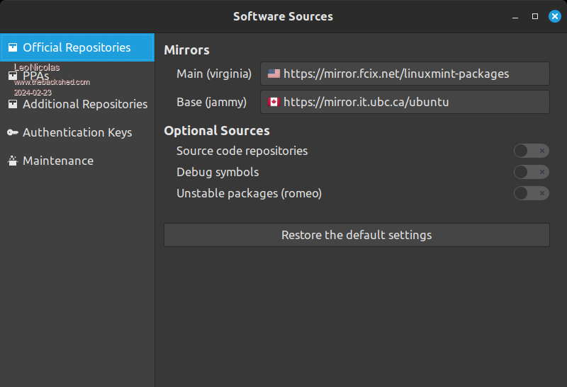

1) Uninstall wine "sudo apt remove wine-hq-stable"
2) Clean APT "sudo apt autoclean && sudo apt autoremove"
3) Delete the Debian source list. Use the Software Sources app or delete its file from /etc/apt/sources.list.d
4) Run "sudo apt update" to update you local packages list
5) Follow the instructions from https://wiki.winehq.org/Ubuntu adding the repo from Ubuntu 22.04
Install software via the package manager is always better because it will be automatically updated. For deb files, this will not happen.

Yes, you can install new versions of most of the software, including Wine. I was using the Wine 9 stable. Now, I'm using de 9.2 (dev) to test the fix for the input crash. I am working with the Wine dev to test it (see the bug post). And it is running on my Mint 21.3 with no problems.
