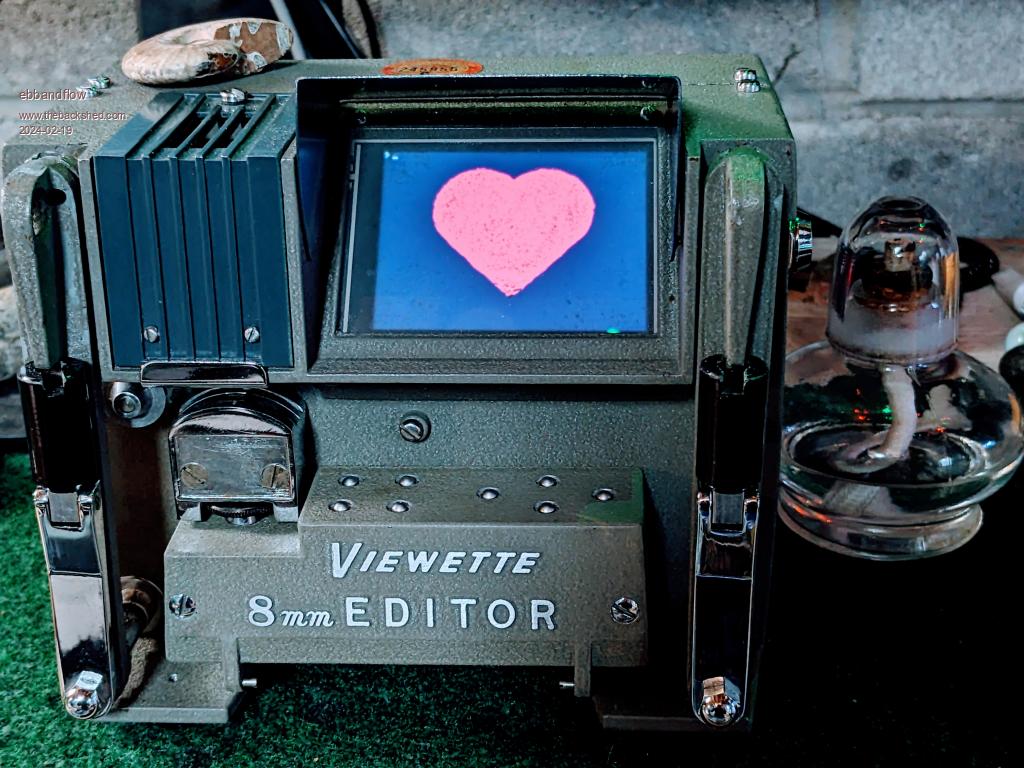

Not a lot to say.
It should run on anything from a geek to cmm2 and MMB4W

It needs the pause to see whats happening.
Translated form PureBasic which was translated from  https://www.shadertoy.com/view/dljyDc

Line 6 includes "h = MM.HRES". Is that as intended? It works fine regardless.
Posts: 6626
Posted: 09:23pm 18 Feb 2024
  vegipete said  Line 6 includes "h = MM.HRES". Is that as intended? It works fine regardless.
That was the deliberate typo to see if anyone was looking.
Either that or I should proofread my work better.
As you probably assumed it should be MM.Vres and if you correct that, you will need to change the end of the line to ys = 0
 Dim Float x, y, p, w = Mm.hres, h = Mm.vres, hw = w/2, hh = h/2,sz, ys = 0
ys was added to make it fit the geek but correcting h was the correct fix.
