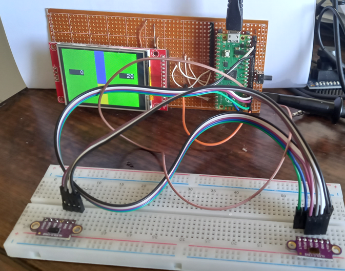

I have been playing with multiple VL53LOX range finder modules.
The following program is intended as a contactless switch - very Covid friendly.
2 modules are connected to the same I2C bus. I used I2C2 but whatever suits.
One module has its XSHUT pin connected to the pico.
To change the address of one of the modules, the one with the XSHUT connected has the pin pulled low to inhibit it .
The other module then gets a new address and the first module released.
We now have two modules with different addresses. This can be expanded as far as you like.
The rangefinders are read every 50mS and then the rest of the code determines if you are swiping left or right. You can also hold a hand close to either module for a simple up/down control. If you want to upset the cat, a pair of tom-toms may be another use.
My initial use will be for a radio control, swiping to change stations and tapping to change volume.
This allows me to control the radio in the shed with oily/grubby fingers or gloves etc.
A video of it in action is on my website
https://www.c-com.com.au/stuff/swipe.mp4

There are lots of PRINT statements which are only for development and can be eliminated.
The I2C scanner is only there to prove the change of address.
pin GP20 is connected to the CRO for timing measurements.
