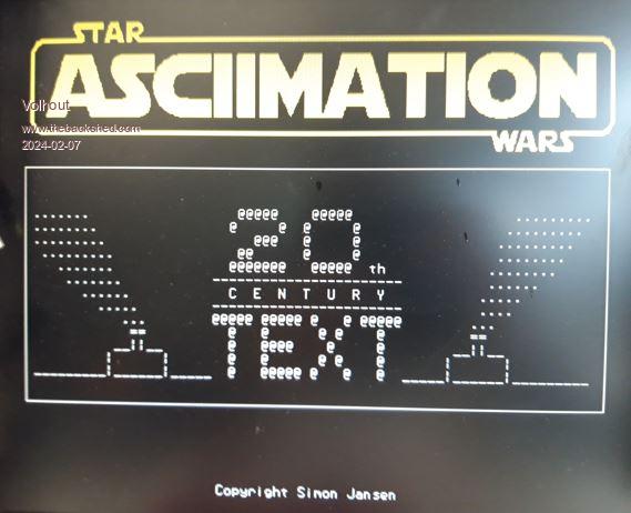

Posts: 6192
Posted: 09:25pm 06 Feb 2024
All,
find attached ZIP file.
It contains the start wars movie, and a test file called "rick_roll.txt"
In it is a file compressor "compress.bas" based on only adding different lines.
it compresses the 95kb file "rick_roll.txt" to 34kb file "rick_roll_c.txt"
in the ZIP is also a player "player.bas" for the compressed file.
This works in MMB4W. Tested on the rick_roll.txt file that is 13 lines x 68 characters video window.
The programs are a little more complex than I expected since MMB4W removes leading <SPACE> characters in a string when reading from a file when using INPUT #1,a$
The player cannot play uncompressed files.
No guarantee for this set of programs, use at your own risk...
asciimovie.zip
p.s. The timer tick in the rick_roll movie is set to 500ms. I thought it was too fast else.
Edited 2024-02-07 07:27 by Volhout

Martin H.
Joined: 04/06/2022
Posts: 1571
Posted: 04:12am 07 Feb 2024
  homa said  Not bad! Thanks for that. BUT where is the sound? ;-)
I'm glad you asked, looking ahead as I am, I created the matching soundtrack about 2 years ago.
Have fun with it
'no comment
Martin H.
Joined: 04/06/2022
Posts: 1571
Posted: 05:22am 07 Feb 2024
  Volhout said  All,
This works on a freshly installed Picomite in Tera Term without any special accessories .
just copy it and the "rick_roll_c.txt" to a:
'ascii movie player VT edition
Open "rick_roll_c.txt" For input As #1
'cls
Print Chr$(27); "[2J";
'Cursor off
Print Chr$(27);"[?25l";
t=1
'fh=MM.Info(FONTHEIGHT)
 'first character in a line
 ch$=Input$(1,#1)
 If Asc(ch$)>127 Then 'movie line
   vpos=1+Asc(ch$)-128
   lin$=""
     ch$=Input$(1,#1)
     If Asc(ch$)>31 Then lin$=lin$+ch$
   Loop Until Asc(ch$)<27
 Print @(0,vpos*10),Space$(68)
   'text 0,vpos*fh,space$(68)
   'Text 0,vpos*fh,lin$
 Print @(0,vpos*10),lin$
 Else  'time marker
   Pause t*250 'previous time
   tim$=ch$
'    do
'      ch$=input$(1,#1)
'      if asc(ch$)>31 then tim$=tim$+ch$
'    loop until asc(ch$)<32
   t=Val(tim$)  'new time marker
 EndIf
Loop Until Eof(1)
Close #1
'Cursor on
Print Chr$(27);"[?25h";
Edited 2024-02-07 15:53 by Martin H.
'no comment
Posts: 6192
Posted: 08:52am 07 Feb 2024
For the PicoMiteVGA users...
Here is the movie player and movie for PicoMiteVGA.
The size will fit on the A: drive of a PicoMiteVGA, but it runs just as well from the SD card.
UNzip, and run "player.bas"
If needed change the variable "fps" to your desired speed.
Have fun.
SW1.zip
P.S. Homa, thanks for compressing
P.S.S. Martin: nice sound track. Would be a nice MOD to attach to the rick_roll move, if we could ever get it synchronous....
EDIT: I noted one line that did not update well at 10 minutes roughy. Not sure if this is in the compressed file or the player. But in general...it works.
Edited 2024-02-07 19:15 by Volhout

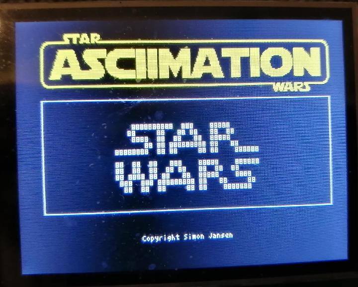

Martin H.
Joined: 04/06/2022
Posts: 1571
Posted: 06:25pm 07 Feb 2024
Here is my version adapted for Game*Mite
GameMite.zip
copy both files in the SW1 Folder and start the GM_Player.bas
Edited 2024-02-08 04:38 by Martin H.
'no comment
