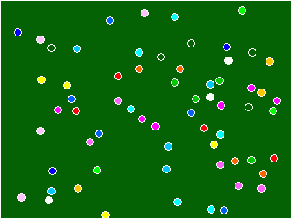

I attach a simple demo program showing a standard PicoMite (or PicoMiteVGA) using all 64 sprites with full collision detection
Option explicit
Option default none
If MM.Device$="PicoMiteVGA" Then MODE 2
FRAMEBUFFER create
FRAMEBUFFER write f
CLS
Sprite set transparent 0
'brownian motion demo using sprites
Dim integer x(64),y(64),c(64)
Dim float direction(64)
Dim integer i,j,k, collision=0
Dim string q$
Drive "b:"
For i=1 To 64
direction(i)=Rnd*360 'establish the starting direction for each atom
c(i)=RGB(Rnd*255,Rnd*255,Rnd*255) 'give each atom a colour
Circle 10,10,4,1,,RGB(white),c(i) 'draw the atom
Sprite read i,6,6,9,9 'read it in as a sprite
Next i
CLS RGB(myrtle)
Box 0,0,MM.HRes,MM.VRes
k=1
For i=MM.HRes\9 To MM.HRes\9*8 Step MM.HRes\9
For j=MM.VRes\9 To MM.VRes\9*8 Step MM.VRes\9
  Sprite show k,i,j,1
  x(k)=i
  y(k)=j
  vector k,direction(k), 0, x(k), y(k) 'load up the vector move
  k=k+1
Next j
Next i
For i=1 To 64
  vector i, direction(i), 1, x(i), y(i)
  Sprite show i,x(i),y(i),1
  If sprite(S,i)<>-1 Then
    break_collision i
  EndIf
Next i
FRAMEBUFFER copy f,n
Loop
Sub vector(myobj As integer, angle As float, distance As float, x_new As intege
r, y_new As integer)
Static float y_move(64), x_move(64)
Static float x_last(69), y_last(64)
Static float last_angle(64)
If distance=0 Then
  x_last(myobj)=x_new
  y_last(myobj)=y_new
EndIf
If angle<>last_angle(myobj) Then
  y_move(myobj)=-Cos(Rad(angle))
  x_move(myobj)=Sin(Rad(angle))
  last_angle(myobj)=angle
EndIf
x_last(myobj) = x_last(myobj) + distance * x_move(myobj)
y_last(myobj) = y_last(myobj) + distance * y_move(myobj)
x_new=Cint(x_last(myobj))
y_new=Cint(y_last(myobj))
Return
' keep doing stuff until we break the collisions
Sub break_collision(atom As integer)
Local integer j=1
Local float current_angle=direction(atom)
'start by a simple bounce to break the collision
If sprite(e,atom)=1 Then
  'collision with left of screen
  current_angle=360-current_angle
ElseIf sprite(e,atom)=2 Then
  'collision with top of screen
    current_angle=((540-current_angle) Mod 360)
ElseIf sprite(e,atom)=4 Then
  'collision with right of screen
ElseIf sprite(e,atom)=8 Then
  'collision with bottom of screen
Else
  'collision with another sprite or with a corner
  current_angle = current_angle+180
EndIf
direction(atom)=current_angle
vector atom,direction(atom),j,x(atom),y(atom) 'break the collision
Sprite show atom,x(atom),y(atom),1
'if the simple bounce didn't work try a random bounce
Do While (sprite(t,atom) Or sprite(e,atom)) And j<10
    direction(atom)= Rnd*360
    j=j+1
  Loop Until x(atom)>=0 And x(atom)<=MM.HRes-sprite(w,atom) And y(atom)>=0 And
y(atom)<=MM.VRes-sprite(h,atom)
Loop
' if that didn't work then place the atom randomly
  x(atom)=Rnd*(MM.HRes-sprite(w,atom))
  y(atom)=Rnd*(MM.VRes-sprite(h,atom))
  vector atom,direction(atom),0,x(atom),y(atom) 'break the collision
Loop
End Sub

Posts: 3885
Posted: 03:48pm 06 Feb 2024
  matherp said  I attach a simple demo program showing a standard PicoMite (or PicoMiteVGA) using all 64 sprites with full collision detection
Neat, though I'm not sure why the image I saved with "SAVE IMAGE" after exiting has a green background rather than the black one on the ILI9341.
Is it "CLS RGB(myrtle)"? Nearly black, so not transparent?
?hex$(pixel(1,1),6) yields 006000
cls rgb(myrtle) actually looks light green on the screen.
