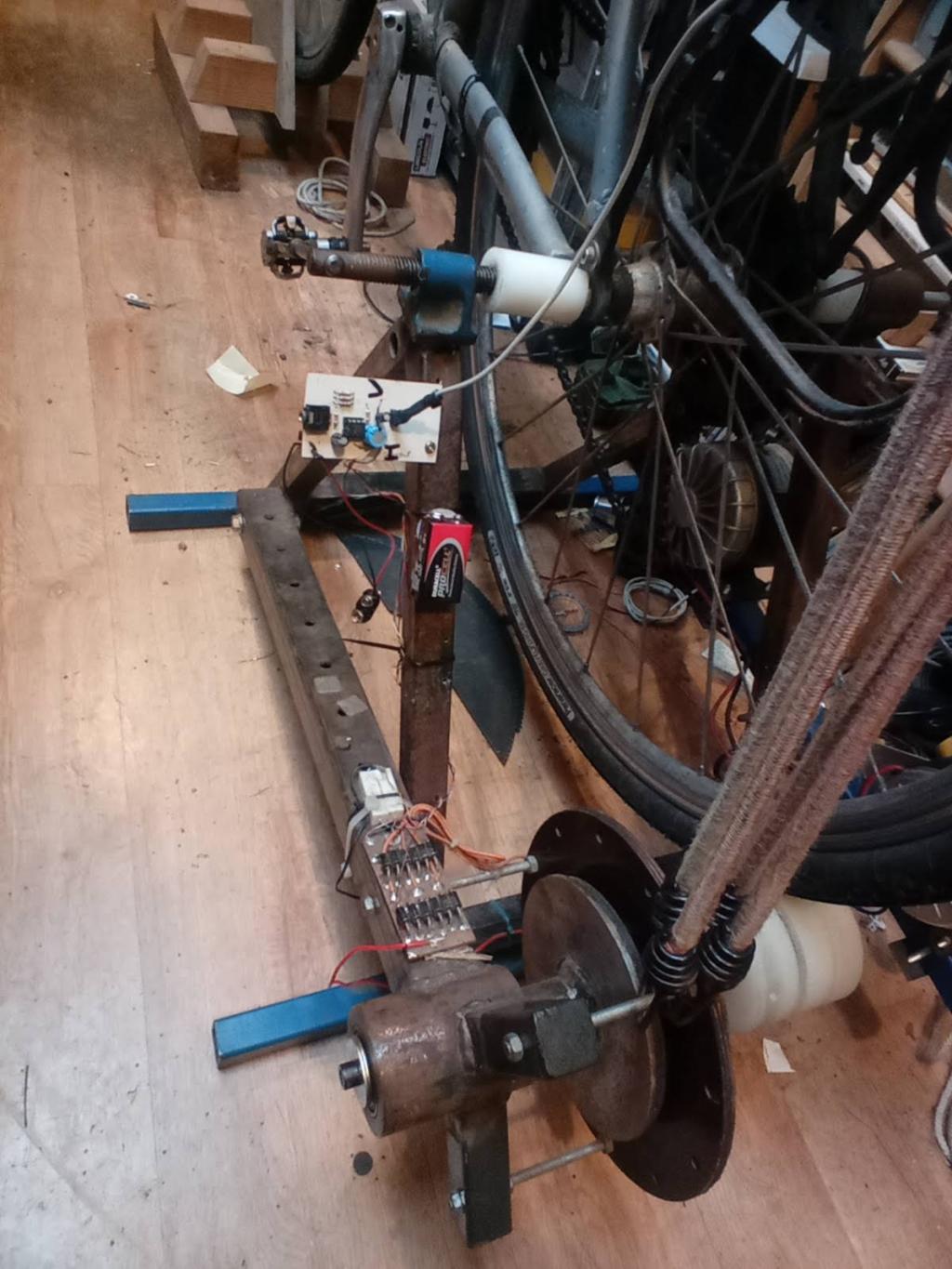

Thanks for the help, my project is a DIY turbo trainer it uses a home made axial flux generator driving 2 mini moto electric motor bike motors with fans. A picaxe reads the current and voltage and sends the data via 433mhz units to a picomite with waveshare display. The data is in the form of UUUUUUUUUUYSM preamble these letters have equal mark space ratio which sets up the bit slicer, when YSM is  detected the next 6 bytes are the voltage current and checksum.

Thanks for the explanation and the photo. Looks like heavy metal (at least for a picaxe). How are you determining the current?
"Turbo trainer"--sorry for my ignorance, but trainer for what, if you don't mind?

A turbo trainer is for putting your bike on to provide resistance to pedal against while going nowhere, useful in the winter when its a bit chilly outside.
The generator and motors provide a really nice feeling load.
The two white blocks are wire wound resistors the voltage across is measured to get the current, the losses are taken into account when calculating the wattage output by the rider.
