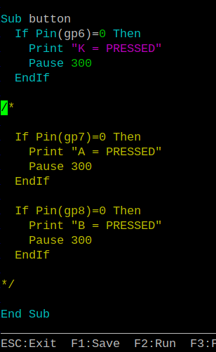

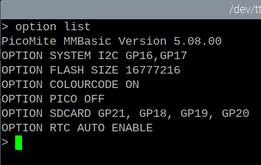

I'm using the newest release of picomite code and perhaps my error is not understanding the wording in the manual regarding multi line comments.

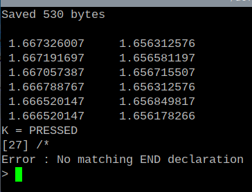

I am getting an error that I think is telling me the end of the comment is missing.
Here are the screen shots;
I just wanted to comment out a bunch of code, without the comments the code all works.
Thanks for your help guys.
Hans ...

I've just tried something similar and it looks to me as if */ isn't closing the comment.
On removing the multi-line comment marks the editor reverts to b/w too, although adding a new ' comment still colours that correctly. Other new commands aren't coloured.

Multi-line comments can't be used inside subroutines and functions - this is a limitation of the way they work
