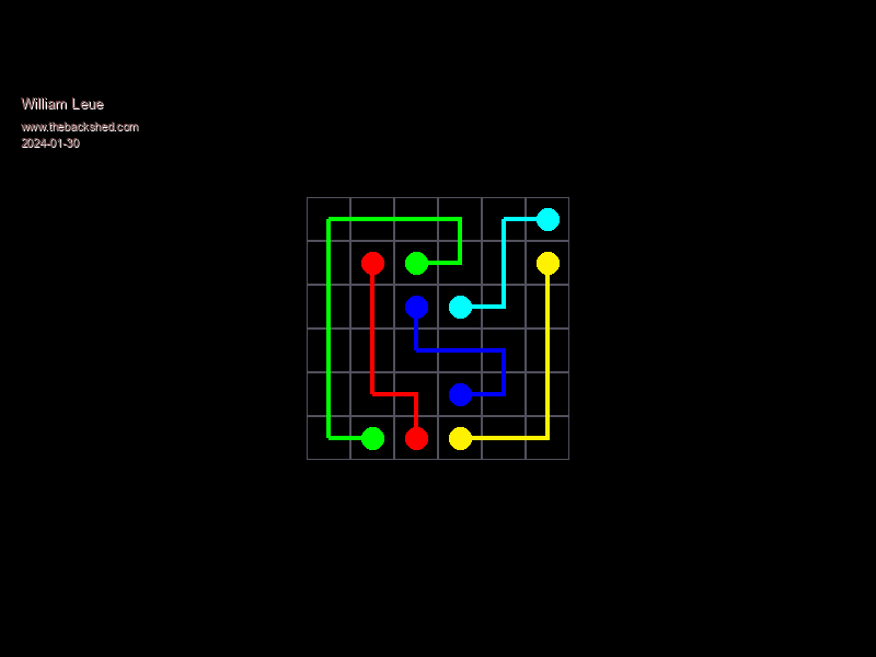

Posted: 11:44am 30 Jan 2024
Hi Bill,
Attached version works (kind of) on picomite VGA.
As you said, minor changes.
If you had written the ShowWin routine using MM.HRES and MM.VRES then the changes would have been even less.
But... I don't know what do with the selection screen. If I scale that to fit the pico screen (320x240) then the puzzles would hardly be recognizable. The color dots would be 2 pixels. Maybe multiple pages would be better. So the selection screen needs some work on the pico version.

EDIT: working on the colors is essential. I think puzzle 4 shows this. There is a "hidden" pipe, probably translated to "black"....
