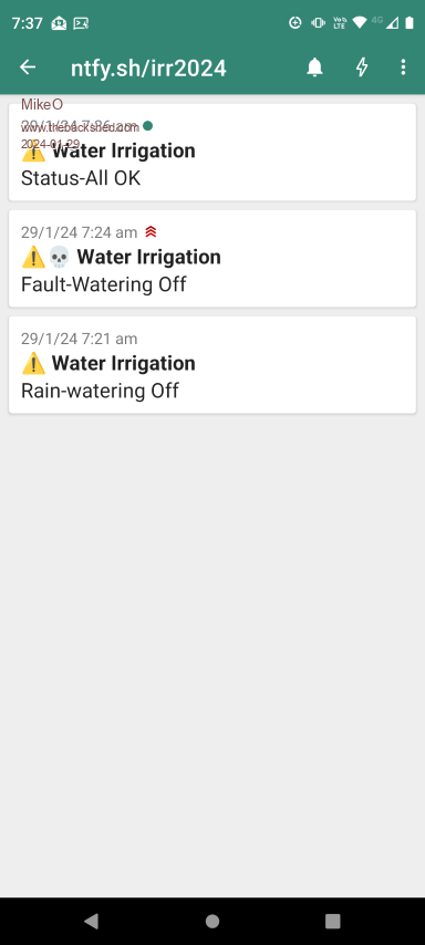

For anyone still struggling with using email as the notification system from Geoff's Watering Controller perhaps this may be worth considering.
I came across this  free service so I thought it may be a perfect solution for the Irrigation system or any time you need to post some info to your phone.
Here is the code with some examples, there are lots more message possibilities see the section in the docs in Publishing>Publish via Get.(Thanks to TheMonkeys code, it was great help in accessing the API) The code will run as is to try , just subscribe to <iff2024> from the app on your phone or web app.
'msg$="message=Reboot"
'msg$="message=Rain-watering%20Off"
'msg$="message=Fault-Watering%20Off"
msg$="message=Status-All%20OK"
ext$="&title=Water%20Irrigation&priority=3&tags=warning"
print notify("ntfy.sh",80,"/irr2024/publish?"+msg$+ext$)
'Send push notification to ntfy
Function notify(servaddr$,servport,tcpreq$) As string
Local return%(64)
WEB OPEN TCP CLIENT servaddr$, servport
notify$="GET "+tcpreq$+" HTTP/1.1"+Chr$(13)+Chr$(10)+"Host: "+servaddr$+":"+Str$(servport)+Chr$(13)+Chr$(10)+"Connection: keep-alive"+Chr$(13)+Chr$(10)+Chr$(13)+Chr$(10)
WEB TCP CLIENT REQUEST notify$, return%()
LongString Print return%()
WEB CLOSE TCP CLIENT
End Function
