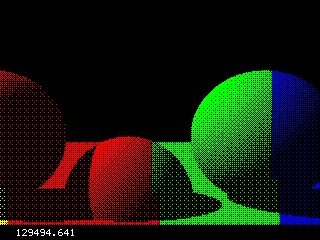

HackaDay readers will have seen the blog posting about a ZX Spectrum Raytracer, in BASIC, which links to Gabriel Gambetta's posting.
I've reworked his program (last iteration) so that it at least runs on the PicoMite. That involved removing all line numbers, gotos, gosubs and other detritus from 40 year old BASIC. I haven't delved into the inner workings to figure out the colour issues.
edit: If I understand the timing, the PicoMite takes less than 2 minutes to do what the ZX Spectrum does in 17 hours.

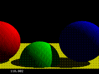

vegipete
Joined: 29/01/2013
Posts: 1185
Posted: 07:58pm 28 Jan 2024
Ok, I dove deeper and sorted the colour issues.
The time at the bottom is in seconds now.
I added some more comments so you can try your own scene details or changes.
The direction to the light source is in (LX,LY,LZ) (line 24ff).
The location and colours of the spheres is in the data statements at the very end. Note that the yellow 'ground' is actually a very large sphere.
X and Y directions are in the plane of the screen, 0,0 at the centre and positive Y is up. Z is in and out of the screen. Presumably we're looking in the negative Z direction, but I haven't checked.
mode 1

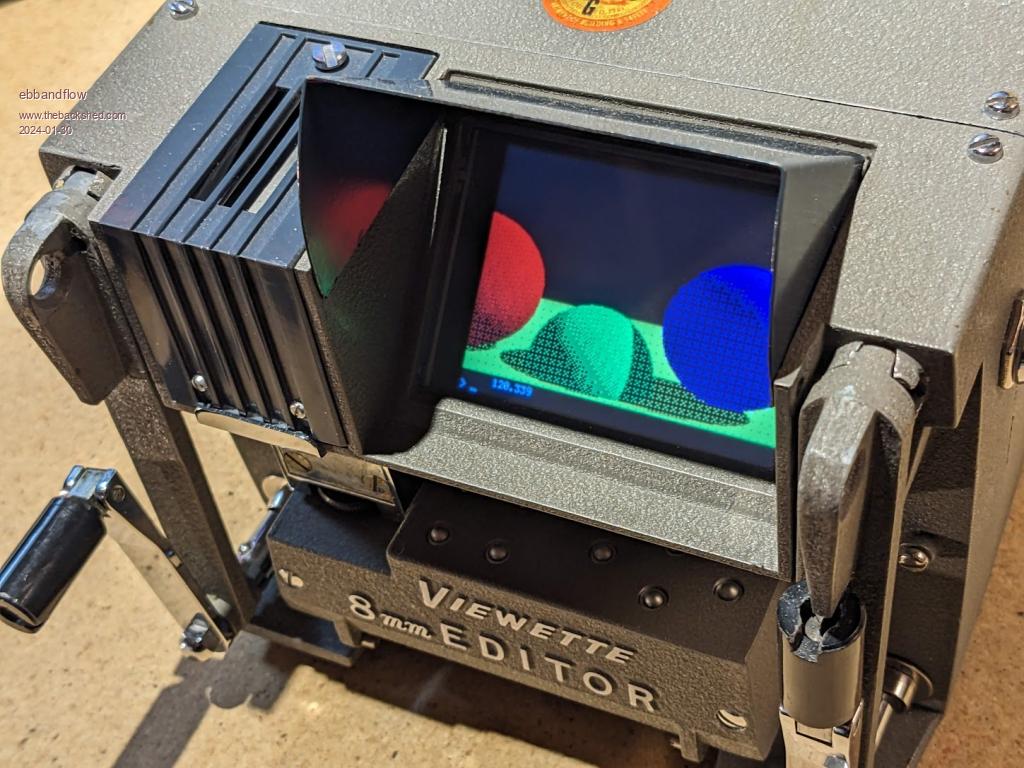

ebbandflow
Joined: 31/08/2023
Posts: 62
Posted: 11:58am 30 Jan 2024
This is really awesome, thanks for sharing.
