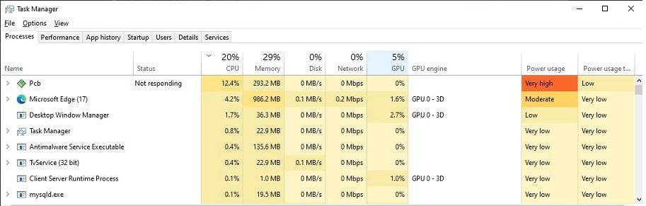

  Quote  Open up windows task manager, view processes and sort by CPU; then watch it as the freeze occurs. May show you if something else in the back ground is hogging resource
Here is a screenshot.

Posted: 04:38am 23 Jan 2024
The only way I can get my version of Diptrace to give a "Not Responding" message is by getting it to search for a component and then attempt to do something else with it.
Where do you have your Diptrace libraries and user defined components stored, if they are on some networked drive, access may be very slow; similarly Diptrace makes a backup of what you are working on periodically, if that was also located on a network somewhere, same thing could happen. Make sure all are located in a local folder, not network located and excluded from checking by anti-virus software.
