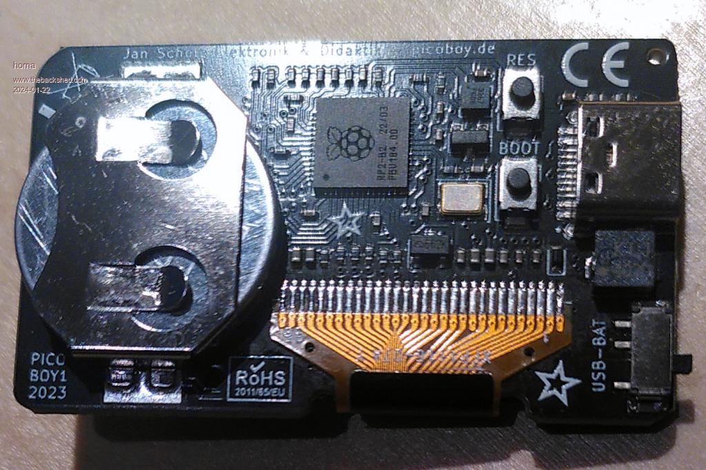

Hi there,
I found this product through a magazine article at GOLEM (https://www.golem.de/news/picoboy-im-test-dieser-lerncomputer-macht-auch-erwachsenen-spass-2311-179186.html ) before Christmas and ordered it to play with:
https://picoboy.de/
https://picoboy.de/einfuehrung/das-geraet/
https://picoboy.de/einfuehrung/fuer-erfahrene-nutzer/
Also in the hope that the PicoBoy would work with MMBasic and not just the MicroPython and C++/Arduino mentioned there.
YES it works with the new version for the PicoMiteV5.08.00
If anyone else in Germany or the EU is interested,
here is the option list:
OPTION AUTORUN  ON
OPTION COLOURCODE ON
OPTION LCDPANEL SSD1306SPI, LANDSCAPE,GP8,GP9,GP10, 2
OPTION AUDIO GP14,GP15', ON PWM CHANNEL 7
OPTION MODBUFF ENABLE

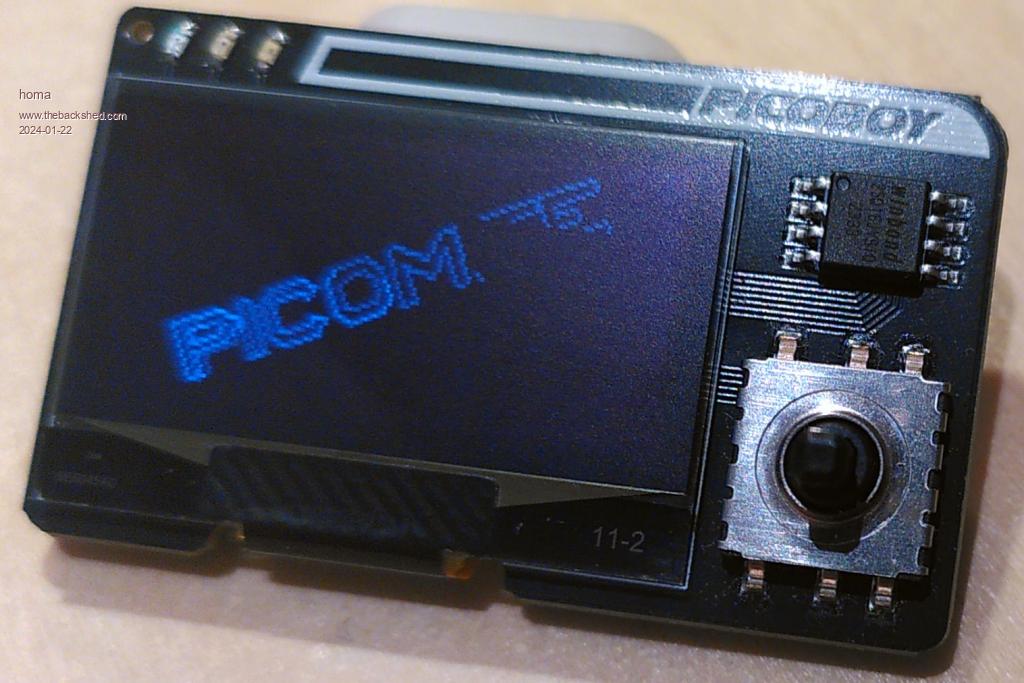

This will run PicoSpin (https://www.thebackshed.com/forum/ViewTopic.php?FID=16&TID=16611 ) directly, the line "FRAMEBUFFER copy F,N,B" has to be copied out.
And playing a MOD file AxelF in parallel :-) So much for the mini-speaker only being able to play sounds. BUT extremely quietly!
Unfortunately no video with sound, just a picture:
I have not yet tested the accelerometer (also due to time reasons). But it should work via I2C. Has anyone got the STK8BA58 running under MMBasic? I would be happy to receive the correct i2c commands for initialisation and reading!
A fun toy for the pico collection.
