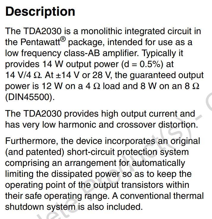

These are quite good, and appear to be genuine 2030 IC's.
US$0.39 each!
The TDA2030 amplifier IC is obsolete and I think discontinued, so these modules will be using up all the old-new-stock.
The IC's seem genuine - laser engraved with the standard ST part ID.
They don't APPEAR to be clones.
IDEAL for mono annunciator type work using an array of three or four little speakers in parallel.  Not very grunty, but...
On-board volume trimmer.
LINK....
14W output @ 14v into 4-Ohms, 0.5% THD.
Not super-HiFi by today's amp standards(and probably not that efficient either), but perfectly suitable for simple tasks.

na , never 14W . beware, maybe 1-2W. i know the specs but this will not work .
Plasma
Posts: 9230
Posted: 08:51am 18 Jan 2024
Nope. Won't happen with that chip at that voltage., not even into 4Ω. The spec implies that you won't get much out of it without at least 16V - and the caps on the board (and the heatsink) won't let you use a proper voltage to get anywhere near 18W. :)

Power is Voltage x Current, or more conveniently V^2/R.
If you want RMS power the easier way is to start with RMS voltage. The reason people like RMS is because the RMS power of an AC signal is equivalent to the same heating effect you get into a load as running a constant DC voltage into the load - it is hard to fudge.
If you have a 16V supply, the best (if you are lucky) you can hope to get out of the amp is 16V peak-to-peak. This is 8V peak. RMS voltage is approximately 0.7 times that or roughly 5 volts.
So the best case RMS power into 4 ohms is 5 x 5 / 4 which is around 6 watts. Supply voltage is not the only parameter as people have come up with many clever ways to get lots of power with small supply voltages, but most modules are class D or class AB and the calculations are correct for those modules.

The datasheet does say this - which is where I quoted the stats from:
Looks like @ 28v, you can get 12W from it into 4R, which sounds reasonable.
Not sure what their quote above that is all about with 14W into 4R @ 14v, but perhaps it was a misprint.
Perhaps they meant 4W?
Posts: 3415
Posted: 07:25am 19 Jan 2024
+/-14V = balanced supply WRT 0V = 28V single supply.
