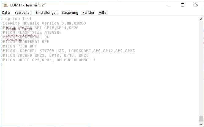

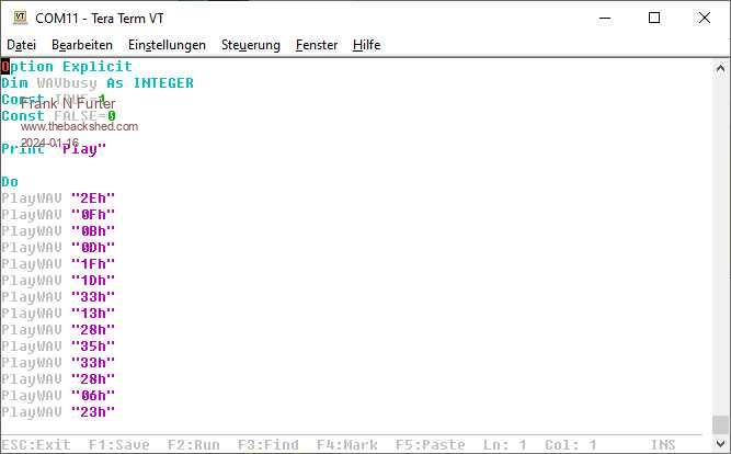

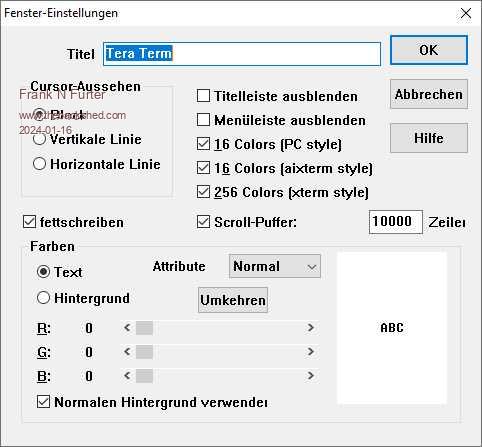

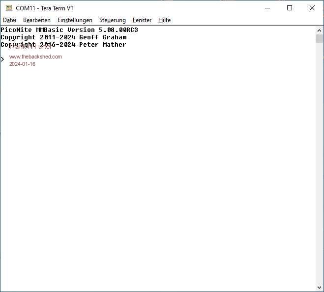

My second problem concerns the color display with Terra Term.
I have inverted the color scheme because I can read better on the light background.
So far this has not been a problem. In the editor, the font (instead of black) was ONLY displayed in a more illegible light gray with OPTION COLORCODE ON.
With OPTION COLORCODE OFF, or when you left the editor, the font was crisp black again.
Now, however, it is illegible light gray even with COLORCODE switched off and after exiting the editor.
However, when restarting (before calling the editor), the font is black...
This is what it looks like in the editor:
This is what it looks like after leaving the editor:
The WAV problem and the editor problem already existed with PicoMite_Beta V5.08.00b5, but I only noticed it in the last few days.
With PicoMite MMBasic version 5.07.06b9 I had at least no problems...
