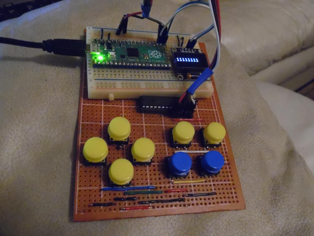

I got mcp23017 port expander and ssd1306 on same i2c to show buttons pressed as binary and works fine...button pad is not as simple to make as seems :)

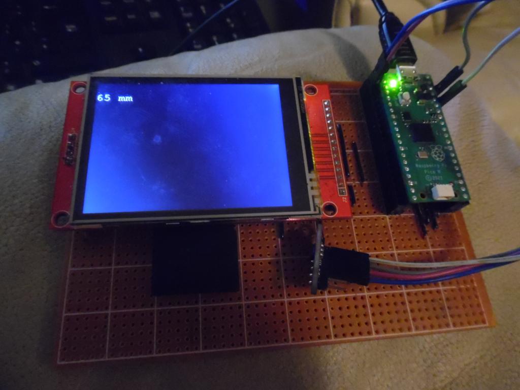

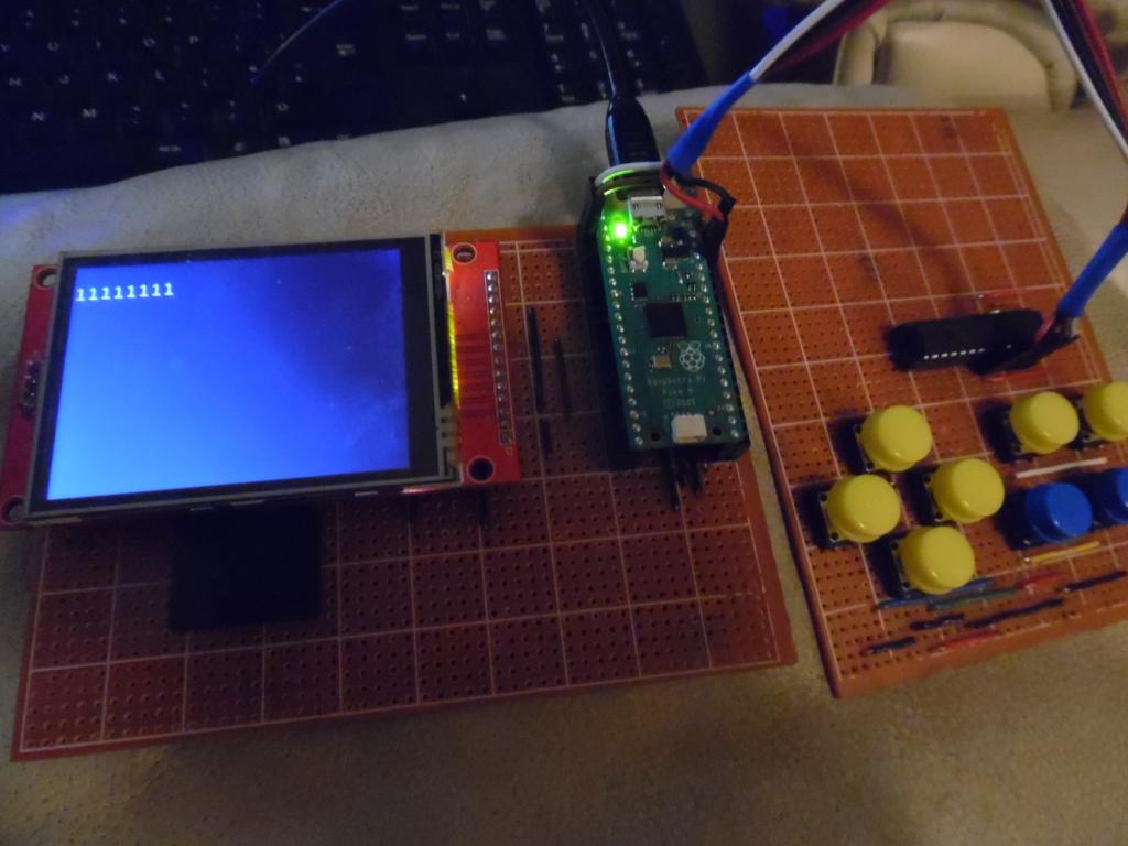

When wired to ili9341 it displays 00000000, so display is working ... but on ssd1306 it's 11111111 for no buttons pressed. works well, pressing 8 buttons gives 00000000.

this is the ili board so 'SETPIN gp20, gp21, I2C not used?? ok for i2c?
> option list
PicoMite MMBasic Version 5.07.08RC18
OPTION AUTORUN  ON
OPTION CPUSPEED  378000 'KHz
OPTION LCDPANEL ILI9341, LANDSCAPE,GP15,GP14,GP13
OPTION TOUCH GP12,GP11
GUI CALIBRATE 0, 3918, 3699, -895, -681
OPTION SDCARD GP22
OPTION SYSTEM I2C GP20,GP21 gives
Error : Pin 26/GP20 is in use
Edited 2023-12-18 09:55 by stanleyella

I'm reading portB, should have changed the var name to portBbits.
It works with it wired to same i2c as the ssd1306, it's the i2c and spi ili9341 which is a different board and pico.

I used OPTION SYSTEM I2C gp0,gp1 and it works with ili9341 board ok now??
Is option reset the only way now to change the system i2c now to other pins?
