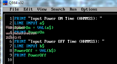

Under Basic it should be
PRINT "Input Power ON Time (HHMMSS): "
LINE INPUT a$
PowerOn = VAL(a$)
PRINT PowerOn
PRINT "Input Power OFF Time (HHMMSS): "
LINE INPUT b$
PowerOff = VAL(b$)
PRINT PowerOff
Same program in QB64 work fine !
So for me it's a PicoMite BUG
