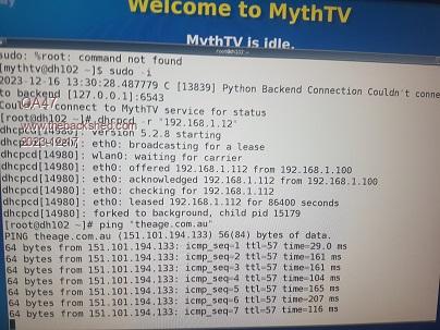

I decided to give my Home Entertainment PC a bit of a birthday as it was still running Windows 7 with Media Player. I looked at an alternative package as Windows does not support Media Player any more. I liked the look of LinHES as it seems to have a similar feel to the Microsoft product and installed V8.6.1 on the hard disk. I have very limited experience with Linux OS configuration and despite hunting through the setup areas I cant get areas of the software to operate. My first major problem I think is that I cant get the unit to connect to the internet via the the cabled ethernet and although it seems to have gained an IP address of 192.168.1.12 and I have set the router address to 192.168.1.100.
Any suggestions before I give up?

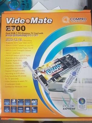

  OA47 said  I want to install a home media OS on a Home Media chassis that supports remote control, remote keyboard, free to air tuners,  front LCD display as well as other dedicated hardware.
Interesting!  Which tuners?
(I'm using MythTV with two Astrometa DVB-T2 tuners, having tried TVHeadend, Xbian & Kodi.)
OA47

@JohnS
0A47

Thanks. I'm using tuners which are DVB-T2, much cheaper & USB (suits me better than PCIe).
You mentioned an odd-looking router address - is it correct?
192.168.1.1 would be more likely, but look at its label / documentation.
If it is correct, maybe look at
ifconfig -a
and
route -n
for clues.
If not root you'll likely need sudo before each of those (e.g. sudo route -n).
Can you ping any sites e.g. aa.com ?

Thanks everyone, it seems that I might have inet access as the screen shows but I have configured something wrong.
