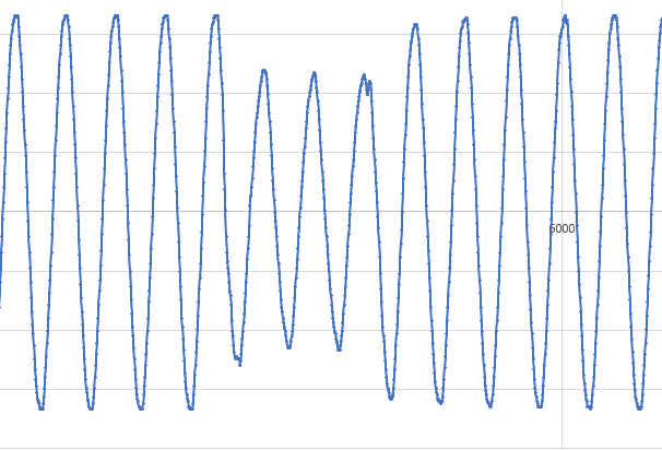

My disturbance recorder has been sitting on the desk in a half finished state for a while now.
Today was it's day to shine.
We are having some severe electrical storms passing by. The closest strike I recorded on the lightning detector system was 0.8kM away in a neighbours spud paddock.
The picomite recorder was ready and this is one of the 'disturbances' recorded.
So far, all the micromites and picomites have survived but there is a few more hours of storms to go.
Posts: 6192
Posted: 07:11am 13 Dec 2023
Nice recording...
But for your equipment not harmfull. Maybe at the neighbours house it is more dramatic...
You can clearly see where equipment switches off.
Posts: 3415
Posted: 07:28am 13 Dec 2023
A textbook recording!
At cycle 5 you can see where the HV surge diverters have blown and are now are now dragging the line volts down about 10%, till the MCB trips or HV fuses blow. Then 2 to 3 cycles of arc quenching.

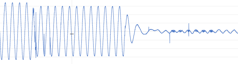

Another disturbance from the same 18 hours of storm cells.
Posts: 3415
Posted: 05:11am 14 Dec 2023
A brief dip like that could be a stick blown across the line.
Posts: 6192
Posted: 06:23am 14 Dec 2023
Neutral gene, 3 phasa unbalance, Someone else tot 300 volt. 60ms. Part of theorie disconnected.
