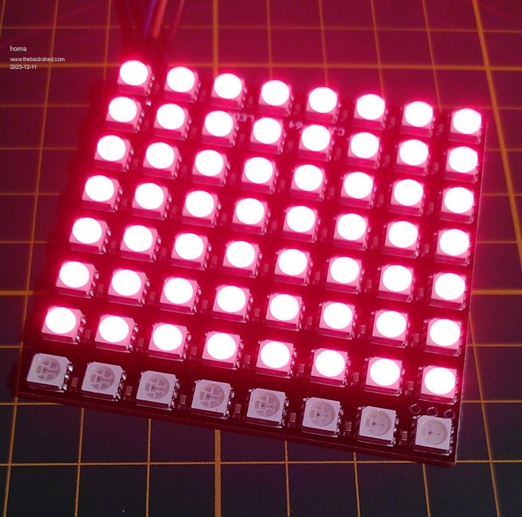

Hello everyone,
I am unfortunately testing this 8x8 matrix for the first time. Is there a defect or is the beta buggy? According to the manual, up to 256 LEDs can be controlled.

homa
Joined: 05/11/2021
Posts: 719
Posted: 06:47pm 10 Dec 2023
I have found another module. The first module is broken! :-(
Posts: 9231
Posted: 06:54pm 10 Dec 2023
Look on the bright side. If you ever need a 7x8 module you'll have one. :)

homa
Joined: 05/11/2021
Posts: 719
Posted: 09:18pm 11 Dec 2023
hello bill,
the message appears with your code:
[6] Device WS2812 O, GP5, 64, b()
Error : Argument 4 must be an integer array
So far my code from above works, the module is simply defective. The second one does.
Thanks anyway.
