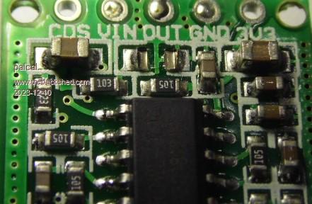

Thanks Jim I've been using au.pool.ntp.org. Everything seems to be working OK as far as the PicoWeb is concerned. Now having a bit of trouble with the RCWL-0516 Radar Sensor, it was working OK, just ordered some more.
palcal
Joined: 12/10/2011
Posts: 2053
Posted: 03:49am 10 Dec 2023
Found out why the Radar Module did not work.There is a cap missing top of photo. I have 5 one is OK one had the cap floating around in the wrapper and 3 had no cap at all.
palcal
Joined: 12/10/2011
Posts: 2053
Posted: 03:04am 12 Dec 2023
I used the one with cap still attached but still had trouble, I found that whilst the cap was stuck in place it was not connected. I removed it, cleaned and resoldered.
Now working OK. These boards are not very good quality but what can you expect for cheap boards from China.
