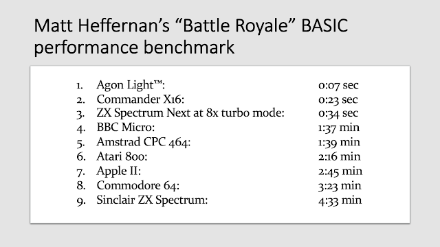

Well, I am a silly sausage. I've been looking at the how the CMM2 stacks up to the current competition. The Agon Light makes a big deal as to how fast it's basic is, and they publish a table on their website showing it compared to other computers using Matt Heffernan's Mandelbrot benchmark.
So, I thought this would be an easy win, and punched the benchmark into my CMM2 - but try as I might, I couldn't get it running as fast as the Agon.... or so I thought. The CMM2 consistently runs the program in 136 milliseconds, how on earth was the Agon posting 70 millisecond times?
Ah - this is where my stupidity comes in - that doesn't say 0.07 seconds - it says 0:07 seconds - i.e. it takes the Agon 7 seconds to draw the test.
All is right with the world again.
Even in Assembler, the Agon takes 0.7 seconds - see video below. So, the CMM2 BASIC is 5 times faster than the Agon Assembled version.
