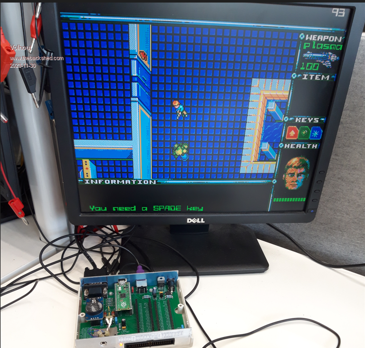

The game will run on:
- Picomite VGA platforms, using keyboard control
- Game*Mite platform (LCD), using the 8 buttons for playing. You must start the game using the keyboard though, since it is not autorun becuase you replaced the GameMite firmware.
- PicoGameVGA platform, using either keyboard or NES controller.

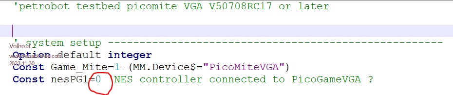

To enable the NES controller for PicoGameVGA boards, change the option in line 7 of the program from "0" to "1".

There is a bug in the code
  Quote    Option default integer
 Const Game_Mite=1-(MM.Device$="PicoMiteVGA")
 Const nesPG1=0 'NES controller connected to PicoGameVGA ?
 If Game_Mite Then
   nesPG1=0:sc$="f":init_game_ctrl ' Init Controller on Game*Mite '************
 Else
   sc$="n":MODE 2
 EndIf
 If nesPG1 Then config_nes
Starred line fails as cannot change a constant

Thanks Peter,
We hate these last minute changes. The change was not tested on a Game*Mite. Good thing you did.
pet25e.zip
bugs fixed:
- Peters find: nesPG1 constant definition fault

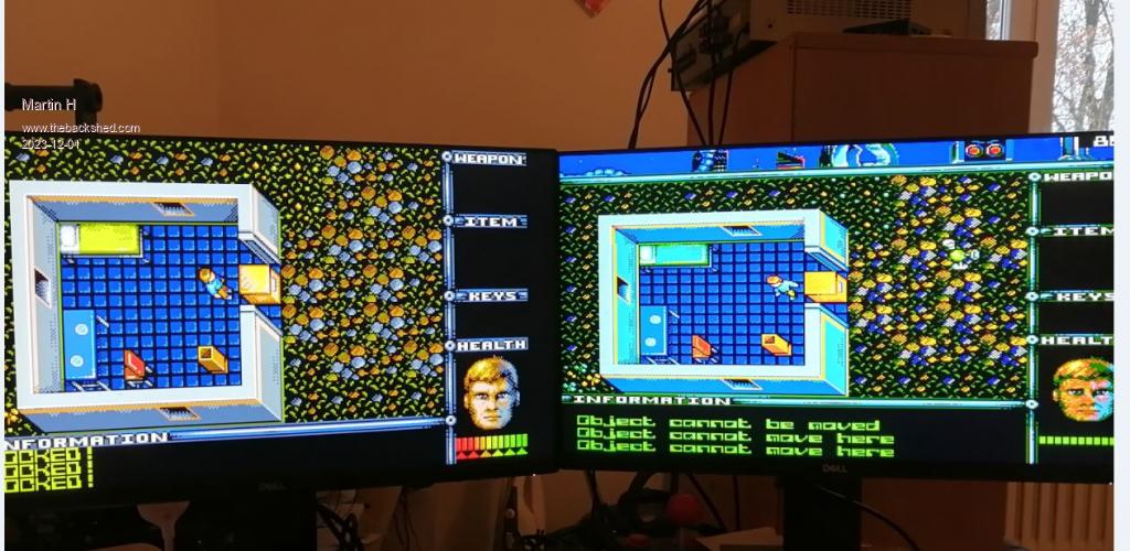

  Quote   when moving a closed box with hidden item, the item moves with it
Yes, tried, works.
In the video I had the problem to have moved away the box and the item was no longer in it.
  Quote  show loading popup
Nice Loading Message ..
If I may make a wish, I would like to have a fade_in from the loading message into the game like here:
'game play variables
 spn=0                   'sprite number
 em_on=0                 '1=is emp active
 mg_on=0                 '1=magent in use
 FRAMEBUFFER write l:fade_in:FRAMEBUFFER write sc$
 Timer =0:playtime=0      'time played in ms
(untested on Game*Mite)

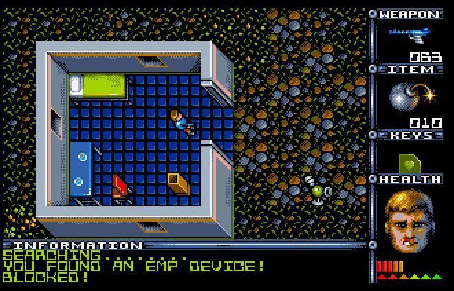

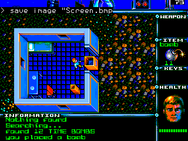

I thought I had found another bug.
You can block your own path by placing boxes in external doors but the same thing happens in the Dos version.
so its not a bug
but There's a slight difference:
In the Dos version, objects in the direct area of the bomb can be destroyed. and you can move on
on Pico they just open and you are stuck .. esc to end the Game
Edited 2023-12-01 19:14 by Martin H.

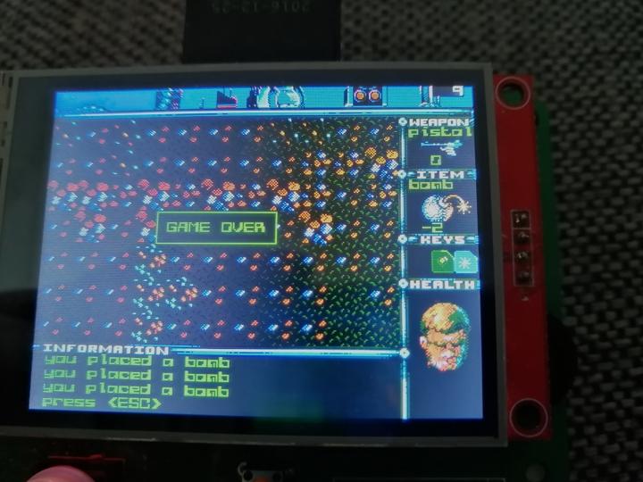

another special feature in the gameplay...
somehow you can have a negative number of Timebombs (and use them)..
Edited 2023-12-02 18:51 by Martin H.

  Volhout said   I assume the plasma gun would also destroy boxes.
I checked it in the DOS Version.
Looks like Plasma gun does not, unless a Canister is near the Box which explosion also  destroys the box.
another little different, in DOS Version you can not place a bomb direct on top of the Bot, in the Pico Version you can. (I don't know if that makes a huge difference in gameplay).
My  strategy is to walk towards the hoverbot until it's sandwiched between me and the wall(or other turning point), then drop a bomb on it and move 3 steps away from him in the direction he is walking.The Bomb would kill the Hoverbot but dont hurt you
This works also in Dos version, but there you have to leave a space between you and the Bot and place the Bomb there.
Edited 2023-12-02 23:00 by Martin H.
