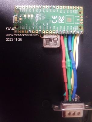

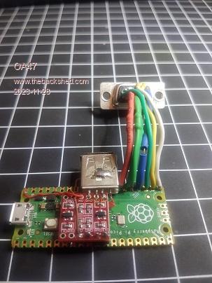

Here is my minimum parts build Pi Pico VGA.
I can double sided tape it to the back of the monitor. I have chosen a monitor that has a USB port and the USB keyboard supports PS2 connection.
0A47
Edited 2023-11-28 14:03 by OA47

Wow, so small!!!
It makes the RPi Pico look like a giant.

  Quote  Wow, so small!!!
Geoff, I presume you are talking about the level shifter board and I am only using half of it.

Posts: 4355
Posted: 08:34am 28 Nov 2023
What's on the underside of the Pico board?
OA47
Joined: 11/04/2012
Posts: 1050
Posted: 08:41am 28 Nov 2023
  Quote  What's on the underside of the Pico board?
Posts: 4355
Posted: 04:28pm 28 Nov 2023
Oh - the resistors are inline with the wires. Sorry, I didn't see that initially.

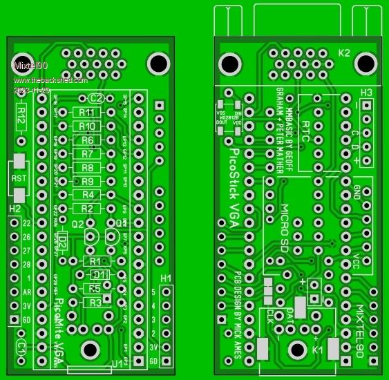

I did a PicoStick some time ago. I cheated and used a PCB though. :)
gadgetjack
Joined: 15/07/2016
Posts: 233
Posted: 04:55pm 28 Nov 2023
I have built a couple of Mick's PicoSticks that work great!
