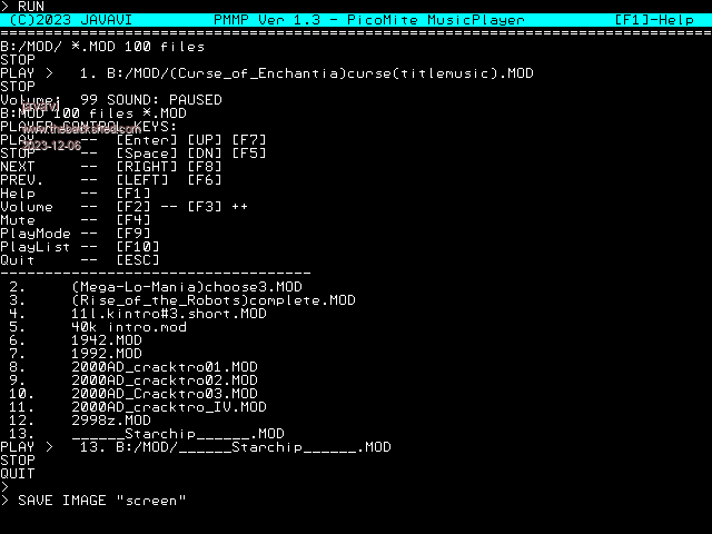

A simple MOD file player for PicoMite/VGA
PMMP - PicoMite Music Player
PMMP.zip
