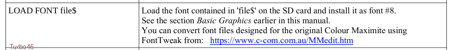

Posted: 01:43am 20 Nov 2023
I Think you need 'LOAD FONT file$'.
The Manual says:

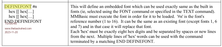

Posted: 01:52am 20 Nov 2023
Or Definefont:
