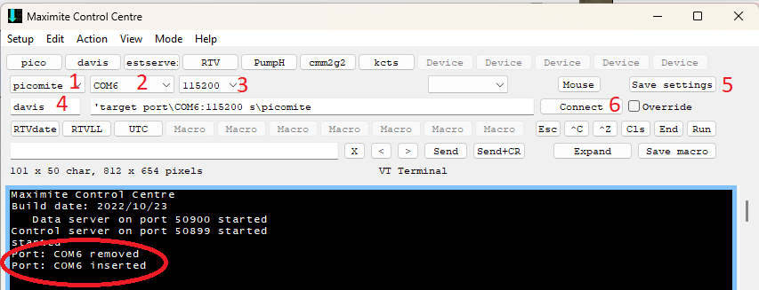

The simple way to use MMCC is:
1. Device type - picomite, CMM2, micromite etc
2. port name
3. port speed For picomites using the inbuilt USB port, the baud rate is not significant but must be present.
4. it is a good idea to give the device a nickname and
5. save the settings.
If you have a number of similar devices, you may want to change the port number each time before connecting.
Now when you edit a code file in MMEdit and are ready to send it to your device for testing, one click on the right most tool bar button "Load file and run it"
<F2> is the keyboard shortcut for "Load"
Edit: MMEdit's editor plus TeraTerm works well if you don't want the file manager in MMCC.

I like the combination of MMEdit & MMCC.
The colour coding of MMEdit is good and pressing a single button to send the file to MMCC
is even better.
In MMCC I only fill in 'Connected Device' , 'Serial Port' and 'Serial Baud Rate'
Press 'Save Settings' for next time.
Then simply press 'Connect'

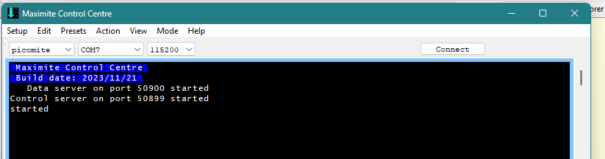

I have heard the comments about MMEdit being a bit daunting at first so in the next update there will be the old "Full menu" mode and a new "Brief" mode which will be the default.
I hope that will help.
