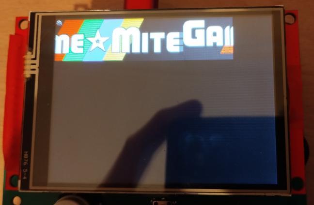

I'm trying to show a JPG on the PicoMite:
Cls
splash.zip
And the result is even less satisfactory than the photo :
Martin H.
Joined: 04/06/2022
Posts: 1571
Posted: 04:35pm 19 Nov 2023
same result,
even  if I copied it to a 320x240 Picture ...
As long as it is jpg, picture looks terrible,
but BMP works as expected
Edited 2023-11-20 02:46 by Martin H.
'no comment
Posts: 3415
Posted: 08:54pm 19 Nov 2023
Results vary depending on the image editor. Got best result with IrfanView but still a narrow strip moved from RHS to LHS.
It seems there are different ways to encode a JPG but this decoder can't cope with them all.
A work-around would be to first reverse-butcher the image so the decoder restores it.  ;)
Or use Blit to rearrange it.
Edited 2023-11-20 06:56 by phil99
Posts: 12045
Posted: 09:15pm 19 Nov 2023
There is a bug I introduced in the jpg decoder when I got rid of a bunch of compilation warnings. In addition, sorting this led me to another day 1 bug when the image isn't either bigger than the screen or an exact multiple of 8 or 16 pixels wide.
Finally, the splash image is crap with varying pixel levels in the flat colour areas which result in a spotty image - that one isn't my fault.
My bugs will be fixed in RC20 when posted.
Posts: 4405
Posted: 10:22am 20 Nov 2023
  matherp said  There is a bug I introduced in the jpg decoder when I got rid of a bunch of compilation warnings. In addition, sorting this led me to another day 1 bug when the image isn't either bigger than the screen or an exact multiple of 8 or 16 pixels wide.
Thank you Peter, hopefully I'll have a chance to try RC20 out this evening.
  matherp said  Finally, the splash image is crap with varying pixel levels in the flat colour areas which result in a spotty image - that one isn't my fault.
Thanks for pointing this out. Assuming it was "good" when initially generated as a BMP on a CMM2 it is probably the result of having been through too many image transformations as I tried to find a .jpg that worked. I'll start again from scratch.
