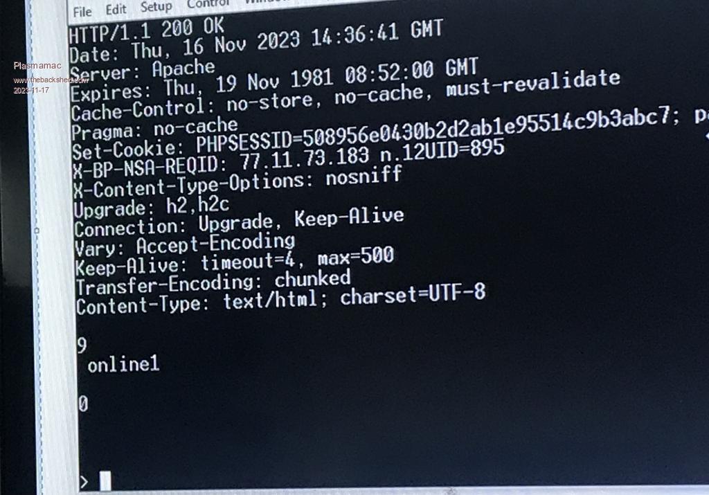

Plasmamac
Joined: 31/01/2019
Posts: 620
Posted: 02:53pm 16 Nov 2023
Thx a lot
Works like a charm
Plasma
