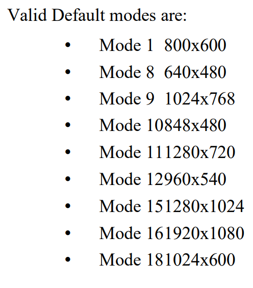

MMB4W
Need colons after the Mode number(?)
Performance is PC dependent (I get 10 to 20 X this value)

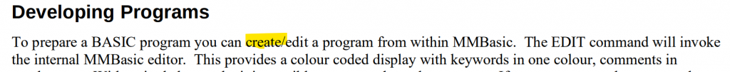

Typo:
To create from scratch: Edit "ProgName.bas"
