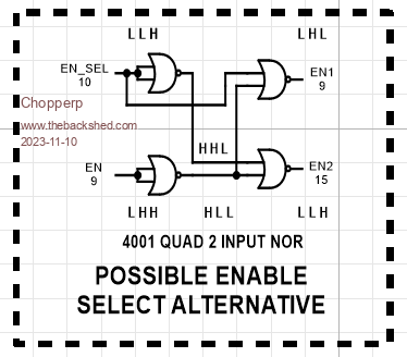

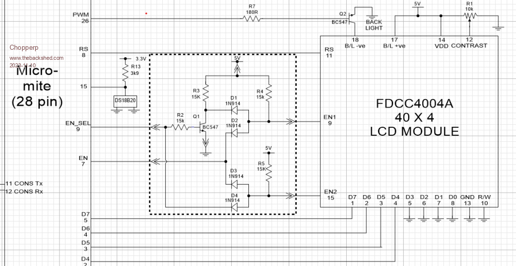

I wish I had had seen @kermess' post back then but it was before my TBS time.  It may have saved me a bit of hassle when I was faced with the same problem. I saw the 40 x 4 LCD on RS many years ago & ordered one.
Robert R's idea of using the O/C outputs is a great idea & allows both sections of the display to be addressed together for some functions as noted e.g. Init & clr. It did not occur to me at the time to do this.
My solution at the time was to used some steering diodes c/w a transistor & resistors with one extra control pin from the 'mite, which combined with the normal EN pin, enabled each section to be addressed separated but, not both at once.
The EN pin enables the interface while the EN_SEL determines which section is selected (0 for top, lines 1 & 2 & 1 for bottom, lines 3 & 4)
I also wrote some pseudo code routines to replace the normal LCD commands.
I may get around to changing to the other solution which is simpler but does use one more pin. I haven't actually used the setup for a while now.
Circuit & code (which may not be elegant, but works) are shown below for interest. I did draw up a later untried version just using a 4001 quad 2 input NOR IC
