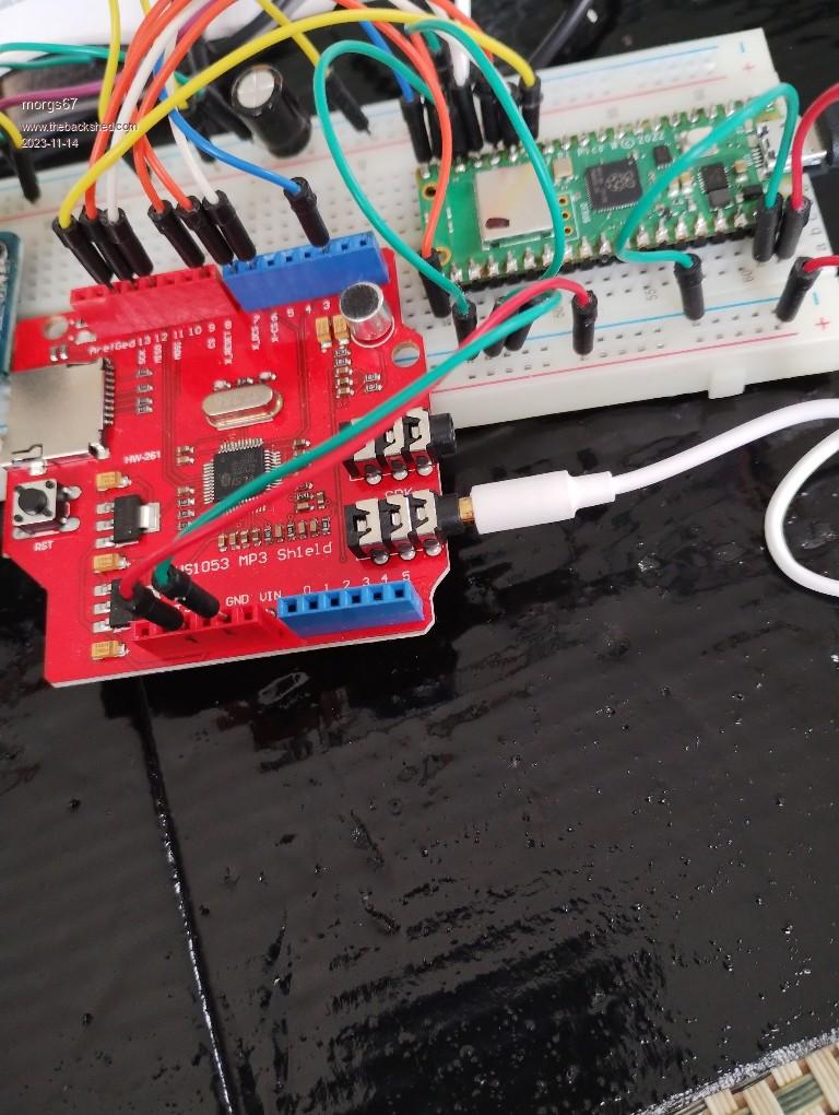

Posted: 07:23am 14 Nov 2023
Tried with a Arduino VS1053 shield similar to Geeetech one.
Works fine.
