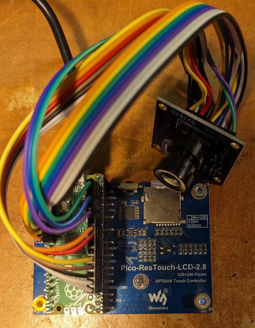

Actually just an extra bitbang command coming soon
BITBANG CAMERA OPEN XCLKpin, PCLKpin, HREFpin, VSYNCpin, RESETpin, DATA0pin
BITBANG CAMERA CAPTURE [scale, [x , y]]
BITBANG CAMERA REGISTER reg%, data%
BITBANG CAMERA TEST tnum
BITBANG CAMERA CLOSE

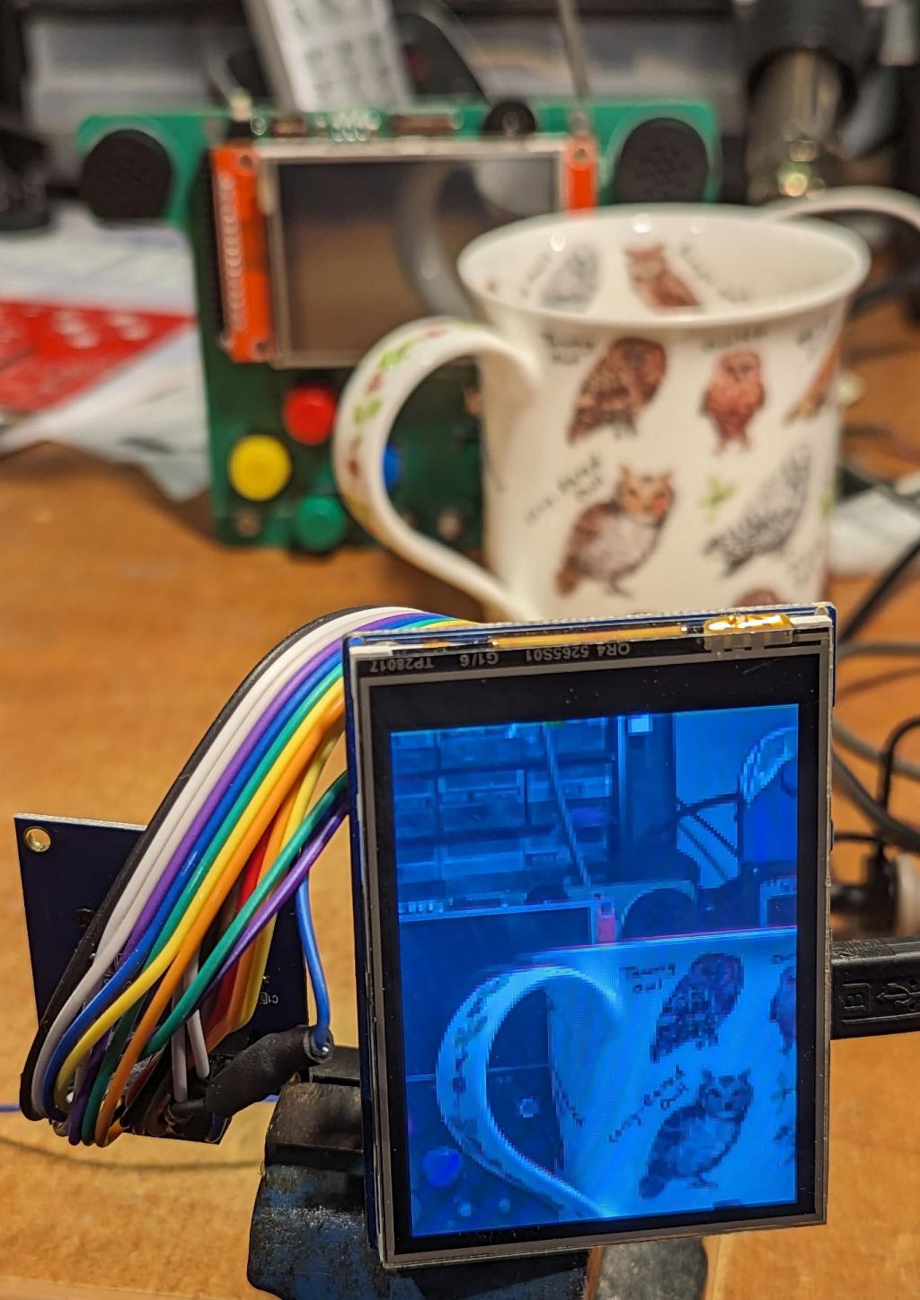

This uses the cheapest version of the OV7670 camera e.g. and captures a 160x120 RGB565 image which it then writes to the screen. The colour rendition is tolerable (much better than it appears in the photo) but could be improved further by tuning the various camera registers. Update rate is 7FPS onto the display at 1:1 scale and 5FPS scaled to 320x240. The camera is set up using an I2C connection which must be defined using OPTION SYSTEM I2C. In all
15 pins are used including the I2C connection. DATA0pin defines the start of a range of 8 contiguous pins (e.g.GP0 - GP7). Pullups on the I2C pins are essential. I used 2K7 resistors.
If there is serious interest I will code up a basic movement detection capability

The code is just a new command for the standard Pico variants
The lens screw in and out for focus and I believe different lens are available (standard 12mm thread)
It is not possible to support any resolution > 160x120 due to the limited memory on the RP2040. The pixels are read into a buffer at 3Mbytes/second
It should work on the web version (untested) but it does have to disable interrupts while capturing the picture which may give an issue
I haven't included on the VGA version thus far as the colour pallet is so limited (RGB121)
I've also now got motion detection working in principal - just need to work out how best to package it in MMBasic for ease of use
