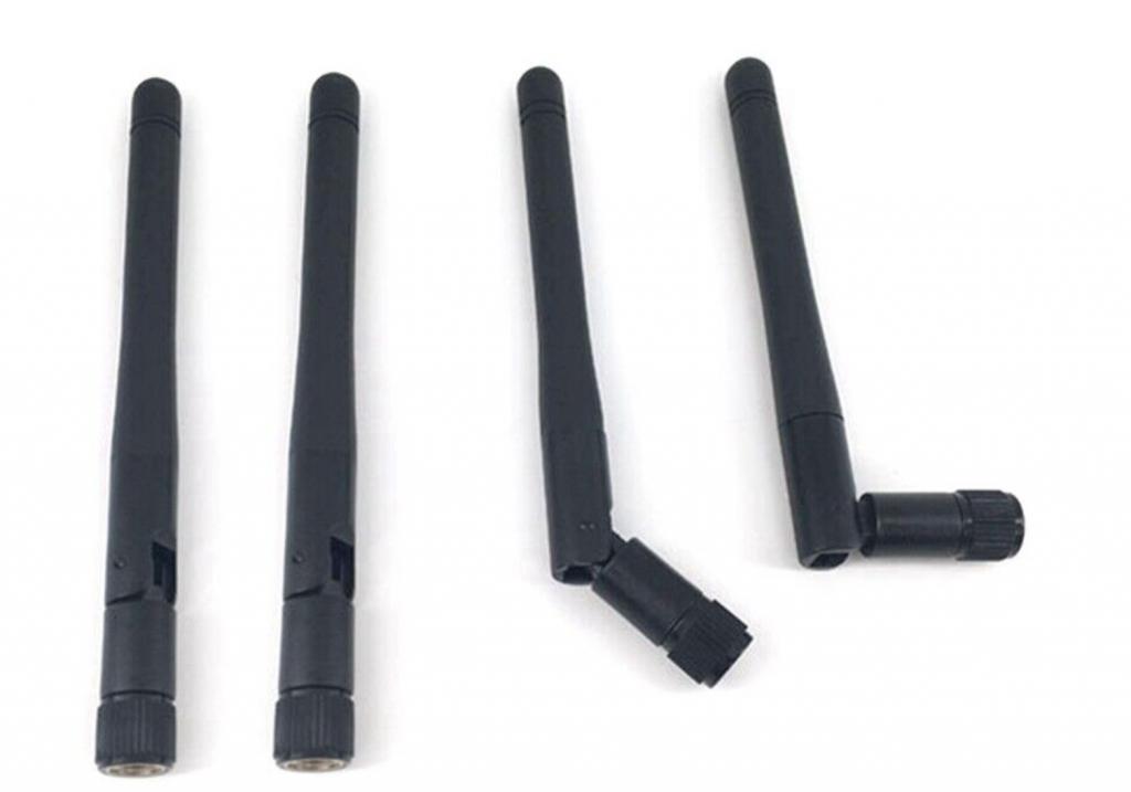

I am looking to get some 433MHz antennae, those short rubbery black ones that pivot in all directions as well as folds down when not in use.
Looks like this one.
But reading the specs confuse me and I am wondering if some sellers are falsely advertising their products (shock horror)

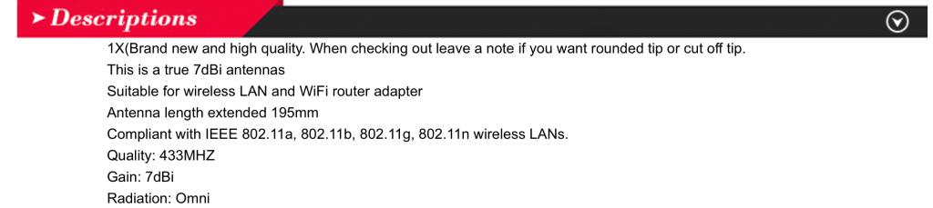

For example here are the quoted specs.
Note that they say suitable for wireless lans.
Aren’t wireless lans 2.5GHz or 5GHz? Some even state these as well as 433MHz in their specs.
I wouldn’t have thought that the antenna could be optimised for all of those frequencies.
Or am I wrong in that assumption?

Probably almost as effective as 6" of wire pushed into the socket. :)
They state 7 dBi (gain of 7dB relative to omnidirectional) so these are obviously directional yet they are also omni? Lovely new invention!
The cavalier attitude to resonant frequency is merely icing on the cake. :)
They do look like the ones normally supplied with wifi LAN cards and routers.

A helical antenna which is what these rubber things are, the wire wound into a spring like form, which shortens it. The shorter the less effective. You cannot beat "wire in the sky"

Mick, I have tried using this type of antenna in the field and I think the gain should be expressed as 0.7 dBi and the SMA connector should not be reversed as in a WiFi antenna.
Unfortunately the antenna did not stand up to the wildlife and the birds dismantled them to reveal that they only consist of a length of wire in a plastic tube.
I replaced them with stainless steel whips and in cases where I needed more gain small yagis.

Thank you for the responses, it seems that I was correct with my suspicion that these sellers are taking us for fools to suggest the antennae can work (and perform) on bands as far apart as 433MHz and 5GHz.
