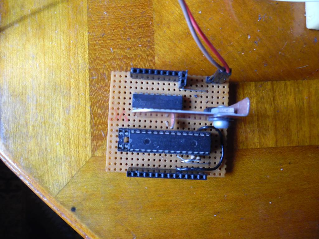

I found another 23017 board from mega 328 and gcbasic code. Used with uln2003 dual stepper motor driver but output only. I used 2 pullup resistors but only needed for i2c leads longer than a foot.
I2c is nice, like I'm using 3 devices on the same 2 pins.
A strip board with a 16 port expander and buttons that I could connect with 4 wire ribbon cable when needed would have been handy so I'm making one.
If I can get weak pull ups to work then is switch from expander pin to ground safe please? stan

stanleyella
Joined: 25/06/2022
Posts: 2807
Posted: 02:31pm 26 Oct 2023
Thanks lizby. Turns out I bought 5, I found the tube with 2 in. The other is on breadboard, the other in a robot and the other on stripboard ready to replace the one in the robot with dual uln2003 not the boards with leds that come with the motors.
