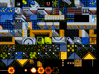

for the start, I rearanged the PSP Tileset for CMM into 2 Pages (Mode 7 - 320x240)
Tile 00-7f
Tile 80-ff
CMM-tileset.zip
If someone dares to adapt Harm's program for the CMM2, that's a start

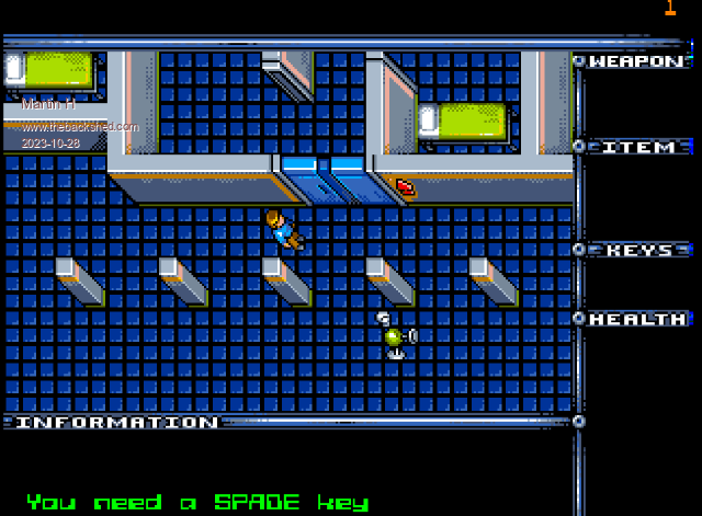

at the moment, I use 3 Pages as Framebuffer to store all the Tiles and Sprites
and use Blit to draw them to page 0
like blit SP_Index(i,0),SP_Index(i,1),xs,ys,24,24,TP1
which works also very powerful (on Windows)
I blit the "sprites" to PAGE 1  (but they are still hidden as PAGE 1 is no "Layer")
this is how it looks at the Moment...
Not all of Harms routines have been adapted yet. (for example Items wapon health are missing). So don't be surprised by any error messages
This is just a snapshot of where I am right now.
you can wander through the levels using Cursor keys and
(ESC)to quit

Ok, i solved the Sprite Problem the easy way.
Using Framebuffer on MMB4W causes it to close regularly, but that's how it works.
I cutout the Sprite Background and saved the Picture as PNG with tranceparency.
Now all the drawing is done at page 1, BG and Sprites, and copy it do Page 0 when done.
'no comment
