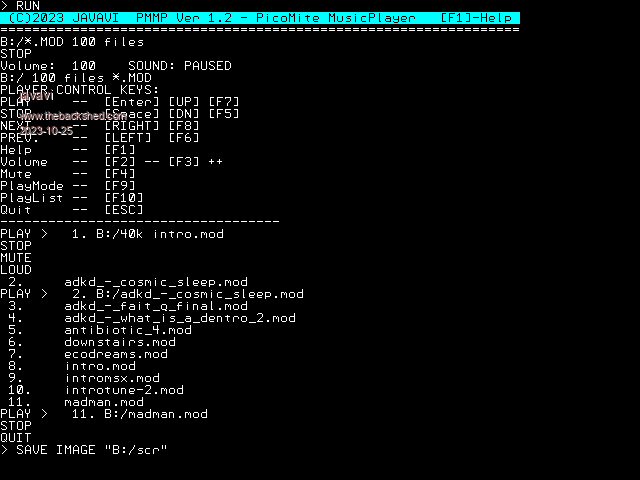

javavi
Joined: 01/10/2023
Location: Ukraine
Posts: 621
Posted: 04:02pm 24 Oct 2023
Hello Everybody!
Introducing my simple player
PMMP -- Pico Mite Music Player
for playing .MOD .WAV .FLAC files
PMMP.zip
Martin H.

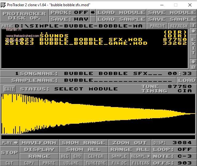

In Pico Petsciirobot I  added all SFX to the Mod, cause the Mod can hold 32 Samples and the Music there mostly uses 10 to 16, therefor the rest "Slots" were free.
Play Modsample plays the SFX while the Music is playing. You have to make compromises because the maximum size of the mod file for the Pico is only 125 kilobytes and the effectsamples alone take up almost 80 kb.

LeoNicolas
try this little example:
I found a short "*.MOD" file. I also found the SFX Samples as 48KHz Stereo mp3 Files on Github and convertet them to 11025 8 Bit Mono using an Audio Editor (like audacity, Audition etc.)
Then used Protracker to add SoundFX starting at SampleNo 16 (&H10)
use this little Test Program
It plays the annoying Music as normal until you press ESC
Pressing keys 1 to 5 plays the SFX while the Music is playing
'Load modified MOD File
Play modfile "bubble bobble sfx.mod"
Bubble=16
BKill =17
Hurry=18
Jump=19
Damage=20
 k$=Inkey$
 Select Case k$
   Case "1"
     Play modsample Bubble,1
   Case "2"
     Play modsample BKill,1
   Case "3"
     Play modsample Hurry,1
   Case "4"
      Play modsample Jump,1
   Case "5"
      Play modsample Damage,1
Case Chr$(27)
Exit
End Select
Loop
Play stop
the modified Mod File
bubble bobble sfx.zip
I hope this makes the principle more understandable
have fun
cheers
Mart!n
