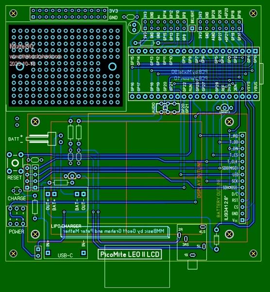

This has a bit of a history. Tom has commented that my PicoMite Backpack was one of the inspirations for his Game*Mite design. I was looking at the Game*Mite the other day (I've been programming on it) and wondered what it would be like as a multi-purpose testbed. Then I realised that, up until now, I haven't done anything quite like that. Stan has been looking at alternatives to PCBs and he uses the ILI9341 so I figured that would be a good approach so...
This design is a right mongrel.  :)
It's designed around the 2.8" SPI version of the ILI9341. It may be possible to use the 3.2" version but I've not got the dimensions for that so don't hold me to it.
It's heavily based on the Game*Mite, using identical GPn pins for the display, SD card and expansion port. One of the GND pins is now AGND.
GP20 and GP21 can be switched between the IO port and stereo audio out (audio uses a simple single-stage filter. Probably OK for 35R headphones).
The keypad GPn pins are now on a second 2x7 header with a similar layout. In theory you could plug some buttons into this and run the Game*Mite software.
There is space for a LM4040 analogue voltage reference.
A "sea of holes" area can be covered by a 170-pin breadboard, so the system can be either temporary or permanent. This is provided with a header carrying 3V3 and GND.
You can fit a battery charger and LiPo battery, using USB-C as the charging port. While charging the PicoMite is switched off automatically. A link can override this. This system is not quite the same as the Game*Mite system. It's impossible to get a feed into the VBUS pin so battery, USB-C and micro USB can all be connected simultaneously if you really want to get confused.
I'll post Gerbers if anyone is interested.

Very nice design. I would have gone for a simpler board like a poundland usb rechargeable li ion battery for battery use.. they were £1.
You use 2 sd card headers and 1 lcd header,
I used 1 sd card header and 2  lcd headers. doh! all the needless soldering and I did that an another board as I have  2 ili sizes both 320x240.

This isn't supposed to be a simple board. It's a multi-purpose PCB and you fit it out with what you want. Something like my PicoMite Backpack design, but with all the terminals accessible from the front.
It's easy to make a little board for a specific display, but you soon find that you need to either build them on veroboard or have lots of variations with slight changes. Also, remember that the cost of five 50mm x 50mm boards is the same as five 100mm x 100mm boards from JLCPCB. You gain nothing by making them smaller and simpler apart from bench space.
There's only one SD card header needed on that board. You can fit it in either position depending on whether the display is 2.8" or 3.2" (untested).
This design replaces the breadboard stage if you fix the 170-pin breadboard down with screws. You can develop the circuit on it, remove the breadboard then solder the components into that area to make a proper system.
You can leave all the battery system off if you don't need it. You can use a flat LiPo battery or an external one if you wish as the connector is easy to get to. You could leave the charger off (fit some links) and simply connect a 5V power bank to the battery terminals.

  Mixtel90 said  It may be possible to use the 3.2" version but I've not got the dimensions for that
Which dimensions would you need?
(I have a board and there may well be info where I got it.)
Posts: 9230
Posted: 03:27pm 16 Oct 2023
At the moment I've no dimensions at all. I need to model it in SL6 to see if it will fit. I've not looked around on the web yet, just gone off Tom's dimension to get the position of the SD connector. There may be a collision with the breadboard (it should *just* clear it).
EDIT:
It looks like it will fit. The top edge of the display just overlaps the lower edge of the breadboard.
Edited 2023-10-17 01:44 by Mixtel90

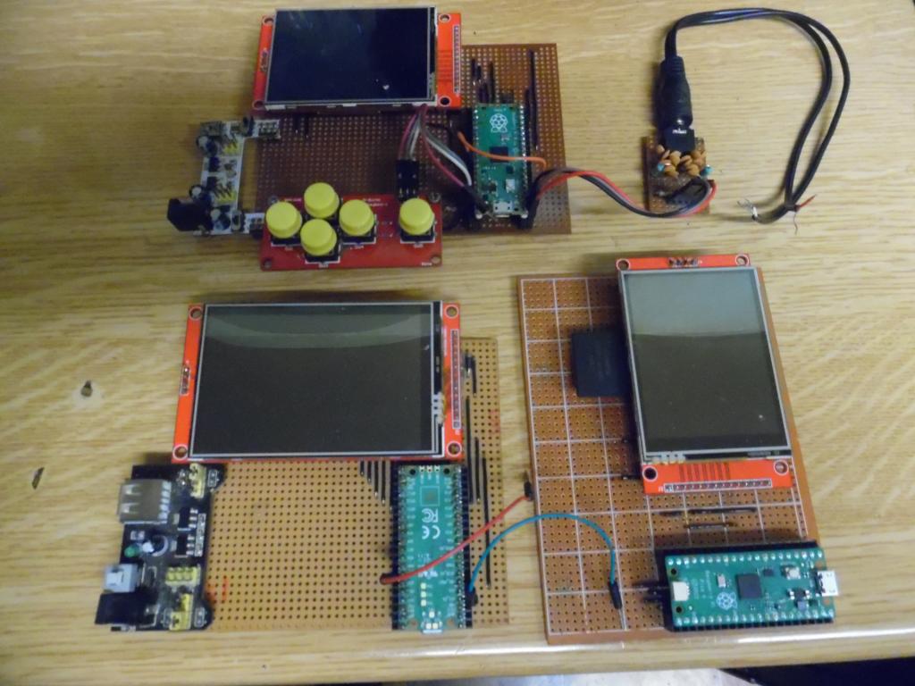

stanleyella
Joined: 25/06/2022
Posts: 2807
Posted: 06:51pm 16 Oct 2023
While I like pcbs I think people cut their teeth with perforated copper strip board.
I don't build permanent boards but ili9341 for a general purpose board then it's an
ili9341 board... which is a great board to play with as it is well supported but why a display on a general purpose board when a terminal will display values?
I was thinking of a logic level converter for arduino hardware and linear 5v and 3.3v supply for noise reduction and 5v power.
my vero efforts. The last no room for the psu like other 2.

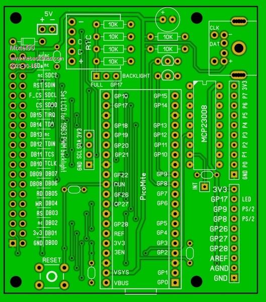

Am also interested in a Picomite PCB design that accommodates the SSD1963.
5" or 7". Needn't necessarily be backpack style.
... Louis

Generally the parallel displays aren't a brilliant match to the PicoMite as they use a lot of IO pins. If you are willing to accept that then it's possible. Whether the SSD1963 is a sensible target now that it has gone much more expensive I'm not as sure.
What sort is your display, Philip?
PhilP
Joined: 25/01/2017
Posts: 41
Posted: 12:48pm 17 Oct 2023
Mick - it is an SD1963-5 800x480 - it was a lot cheaper when I bought it. Yes I realise that a lot of pins will be used up but I feel it will be worth it to get a bigger display. I may be able to multiplex some additional I/O if needed.
Phil
Posts: 9230
Posted: 12:56pm 17 Oct 2023
Ok, I'll sort something out.  :)

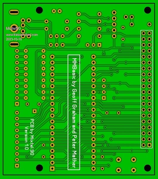

Posts: 9230
Posted: 06:57pm 17 Oct 2023
@ Philip & Louis
Something like this? It's designed to fit behind the 4.3" display so is covered by the larger ones. Some sort of support might be needed for the free end. The only GPn pins not brought out directly are GP20 and GP21, which are used for the I2C interface.
Posts: 4390
Posted: 08:44pm 17 Oct 2023
  PhilP said  Mick - it is an SD1963-5 800x480 - it was a lot cheaper when I bought it. Yes I realise that a lot of pins will be used up but I feel it will be worth it to get a bigger display. I may be able to multiplex some additional I/O if needed.
Phil
How about using it with an Armmite?
(STM32F4)
