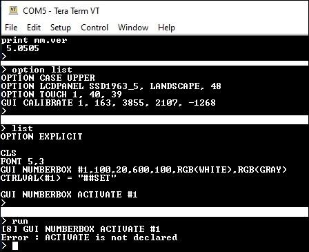

I have an Explore100 with a 5" touch LCD as per the Silicon Chip article.
I can't seem to get the GUI NUMBERBOX ACTIVATE #ref command to work. I'm running MMBASIC 5.05.05. Here's a screenshot of my settings, program and output after typing run:
Am I using the command correctly?

Posts: 10072
Posted: 12:25am 18 Sep 2023
Howdy.
Drop the hash and see if that works - GUI NUMBERBOX ACTIVATE 1
My guess is that the hash is confusing the interpreter, and it is thinking that the keyword ACTIVATE is a variable, and is trying to treat it as such, and then moans cos it can't find a variable with the name of ACTIVATE.
'#ref' in the manual is just a way of referring to the VARIABLE that the command is referencing - the number 1 in this case.
I would probably also drop the hash from the command that sets up the control: GUI NUMBERBOX 1,100,20,600,100,RGB(WHITE),RGB(GRAY)
If that also errors out, then perhaps Geoff or Peter will chime in as there might be an obscure bug.
Edited 2023-09-18 10:30 by Grogster
ElectroPI
Joined: 27/04/2012
Posts: 42
Posted: 12:36am 18 Sep 2023
I tried that already. It seems to not recognise the word 'ACTIVATE' and treats it like a variable.
Using OPTION EXPLICIT gives the error "ACTIVATE is not declared"
Without OPTION EXPLICIT I get "Error : Expression syntax"
PS I just tried GUI TEXTBOX ACTIVATE #ref with/without OPTION EXPLICIT & it gives "Error : Syntax" in both cases.
Edited 2023-09-18 10:42 by ElectroPI

ElectroPI
Joined: 27/04/2012
Posts: 42
Posted: 12:52am 18 Sep 2023
An update - getting rid of all # symbols fixes the issue with TEXTBOX.

Using TEXTBOX:
GUI TEXTBOX 1,100,20,600,100
CTRLVAL(1) = "##SET"
GUI TEXTBOX ACTIVATE 1
The above works properly.
I can replace 1 with #1 in the GUI and CTRLVAL lines and all ok. But the ACTIVATE line will not tolerate #1, it comes back with a syntax error. The # symbol has to be left out which is no major problem.
Using NUMBERBOX:
No combination works - it just doesn't recognise the word ACTIVATE.
I tried the previous version of MMBASIC and still get the same error with GUI NUMBERBOX ACTIVATE 1.

Posted: 04:11am 25 Apr 2024
Hi ElectroPi,
This may not be the answer, but it is a workaround on my Explore 100 with 5”TFT with ver. 5.05.05
My apologies to Geoff, Pete, Phil, etc., if I’m on the wrong horse, but this is my first stab at problem solving.
I am using the OPTION LCDPANEL CONSOLE, which may be causing some of the problems encountered.
Word wrap is not functioning as you might expect, and using font 5 causes an overwrite of the NUMBERBOX created, and for whatever reason nullifies it.
My workaround:
Reset to clear all settings
OPTION EXPLICIT
CLS
GUI NUMBERBOX 1, 400, 20, 150, 50, RGB(WHITE), RGB(GRAY)
CTRLVAL(1) = 35
• Leaves the console font small and therefore eliminates the wordwrap.
• Shifts the box away from console text
• Reduces the size of the box to leave plenty of room for the numeric keypad
• CtrlVal should be a number
• Leaving off the GUI NUMBERBOX ACTIVATE 1 command does not seem to stop it working, at least to that point.
Constructive criticism is a valuable learning system
Footnote added 2024-04-25 14:33 by TasOak
Further testing validates your original script, when OPTION LCDPANEL CONSOLE is disabled, but there may be something to learn from it
Footnote added 2024-04-26 15:35 by TasOak
On even further examination of the MMBasic Manuals, it would appear that ACTIVATE is a keyboard only function of the GUI TEXTBOX Option and therefore not recognised in this case.
