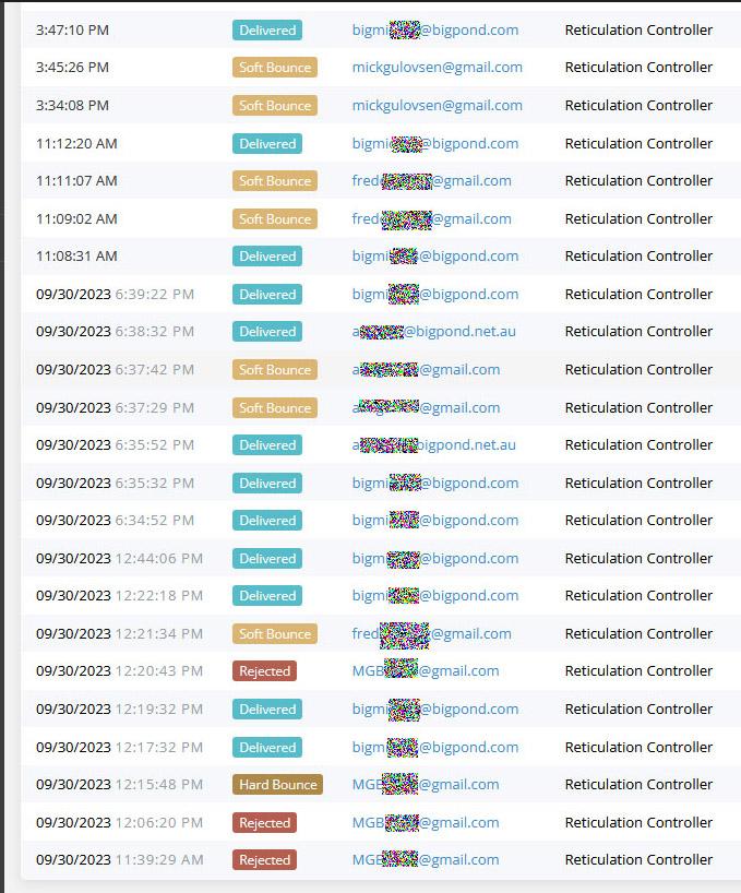

Posts: 2982
Posted: 05:00am 01 Oct 2023
Geoff, All,
It looks like it IS SMTP2GO filtering emails.
See this `activity log' on SMTP2GO.com
As you can see, every GMAIL send attempt is either Rejected, Hard Bounce or Soft Bounce including to AndrewG's GMail accts.
I will do some reading on this.
It is strange that yours go through OK Geoff.
Edited 2023-10-01 15:05 by bigmik
Posts: 3369
Posted: 07:40am 01 Oct 2023
There is a huge amount of effort being put into reducing spam by Google and others.  This includes AI scanning, blacklists, domain verification, etc.  Any of this could be the culprit.
It looks to me that your emails have been rejected by Google so it is not the fault of SMTP2GO.  In the past I have been tripped up by Email authentication protocols such as SPF, DKIM, and DMARC and it sounds as if they are your problem.  Check this paper by Google and  this paper
Edited 2023-10-01 17:54 by Geoffg
