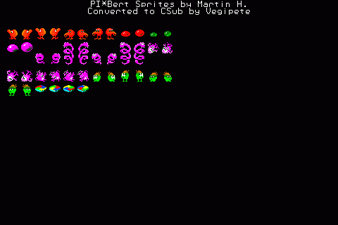

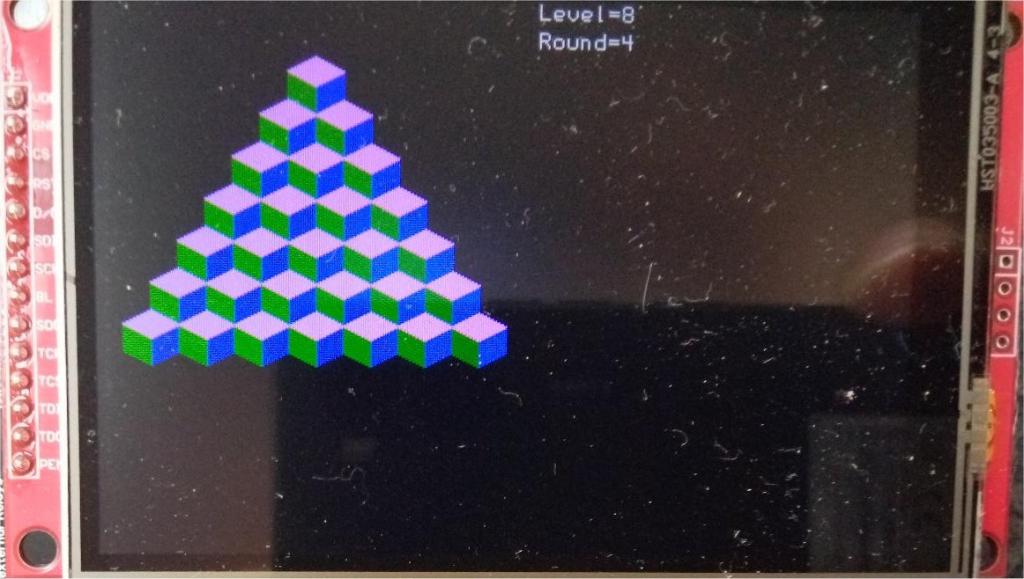

I started to design a Q*Bert-like game for the Pico.
Unfortunately, I don't have the time, at the moment, and patience to create a finished game out of it .
I have already designed the pyramids for 8 levels of 4 rounds and all the sprites.
I would be happy if someone here could finish programming this.
Does anyone dare to do that for PicomiteVGA and/or LCD (Tomboy)?
Mart!n

'Draws the playground in colors 1 (top) 2 (left) and 3 (right)
Sub pyra C1%,c2%,c3%
 tx%=112
 For y=0 To 6
   For n=0 To y:field tx%+32*n,32+24*y,c1%:block tx%+32*n,40+24*y,c2%,c3%:Next
   Inc tx%,-16
 Next
End Sub

'Compressed sprite Data
'always facing left, have to be mirrored when looking to the right
'2nd sprite is the Object jumping
'1 Bert (4 Sprites)

Running on standard PicoMite with 480x320 ILI9488 LCD after replacing "SPRITE" with "BLIT".
Commenting out the first line, "MODE 2" it ran to line 114:  blit show 2-(of%=7), x%, qy%-sw%(of%), 2,1
I commented that out and it ran to Level 8, Round 4, flashing many colors in a triangle of apparent cubes of which you can see three sides (which appear to be the same shape in different orientations).
It crashed at line 59, Blit write n,x+160,y,1
This is what a screen shot looks like after the crash:
I commented out line 59 and then it runs to the same point, Level 8, Round 4, and then, after a pause, it repeats.
(I have no idea what might happen if those lines were not commented out, and know nothing about the game.)

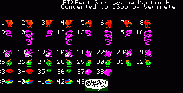

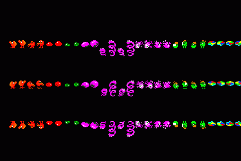

Posted: 03:17pm 27 Aug 2023
On a picomite with ILI9488 480x320 LCD, here's a screen shot of the sprites in normal orientation and flipped with Peter's new code for BLIT WRITE which allows mirroring:
After the sprites are read in and built:
For n=1 To 26: Blit write n,n*18,80: Blit write n,n*18,160,1: Blit write n,n*18,240,2:Next
Edited 2023-08-28 01:41 by lizby
Martin H.
Joined: 04/06/2022
Posts: 1571
Posted: 05:01pm 27 Aug 2023
That's how they're supposed to look.

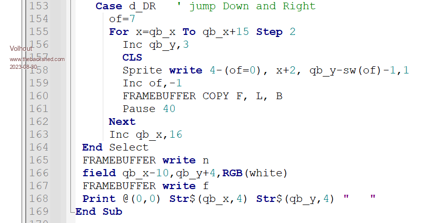

Posted: 06:14am 30 Aug 2023
Use "ax" and "ml" keys to make Q*Bert jump around on his pyramid. Or into space around his pyramid, because there is no bounds checking yet.
PicoMiteVGA Beta 5.07.08.12
autosave

Posts: 6193
Posted: 09:09am 30 Aug 2023
Nice...very smooth moves...
You did not color the top tiles yet...
Insert lines 165..167

Posts: 3885
Posted: 11:42am 18 Sep 2023
That's what it looks like on a PicoMite with ILI9488 with this code:
'autosave
Option DEFAULT INTEGER
If MM.Device$="PicoMiteVGA" Then
 MODE 2
Else
 FRAMEBUFFER create
 FRAMEBUFFER write F
EndIf
Dim glof(50)
Restore GlyphOff
Read n : glof(0) = n
For i = 1 To n:Read glof(i):Next
CLS
Text MM.HRes/2,0,"PI*Bert Sprites by Martin H.","CT"
Text MM.HRes/2,10,"Converted to CSub by Vegipete","CT"
spad=Peek(cfunaddr Glyphs)
x = 10 : y = 40
For i = 1 To glof(0)
 Blit memory spad+glof(i),x,y
 Inc x,20
 If i = 12 Then x = 10 : Inc y, 20
 If i = 24 Then x = 10 : Inc y, 40
 If i = 36 Then x = 10 : Inc y, 20
Next i
If MM.Device$="PicoMite" Then FRAMEBUFFER copy f,n
End
I don't know if the blank sprites are supposed to be blank.
Edited 2023-09-18 21:44 by lizby
