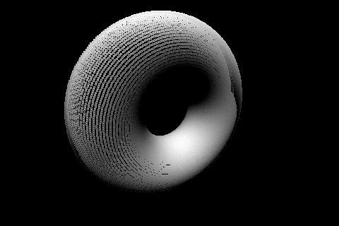

On a 480x320 ILI9488 by a picomite, with BMP file converted to JPG:
