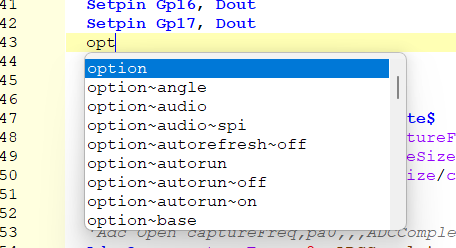

I have been experimenting with multi word code completion which is handy when you forget all the MM.INFO choices etc.
There will probably be an update next week, bugs permitting.

The syntax files are now back to one file for keywords and parameters. They also now have a section for phrases.
This means that auto-completion can have a lot more options for you to choose.
If you don't like auto-completion, you have the option to turn it off.
The ~ character gets replaced with a space when it is inserted into your code.
This is handy when there are a number of sub commands and the memory is not as good as it was...

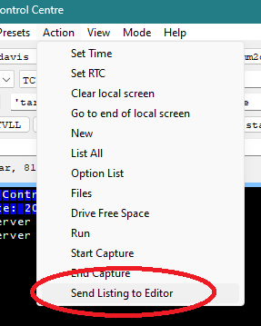

If you are using this method:
The code is sent to the clipboard and then pasted into MMEdit
You can paste into any text editor to see if the formatting is intact.
That will tell me where the problem is. MMCC or MMEdit

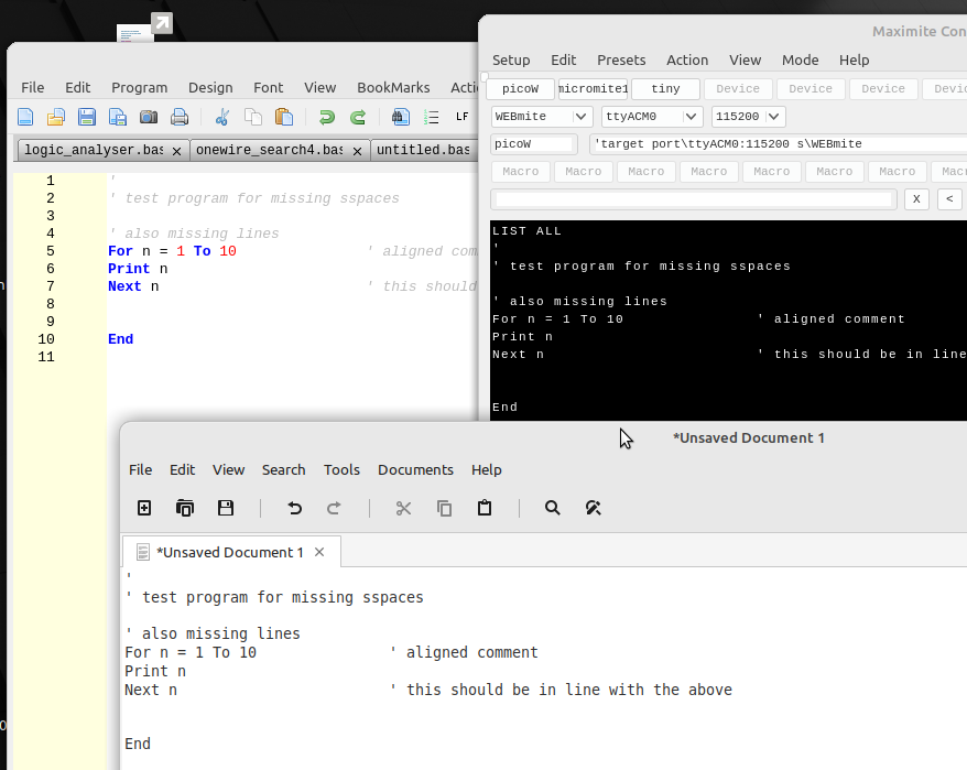

Posted: 01:28pm 12 Oct 2023
Hi Jim,

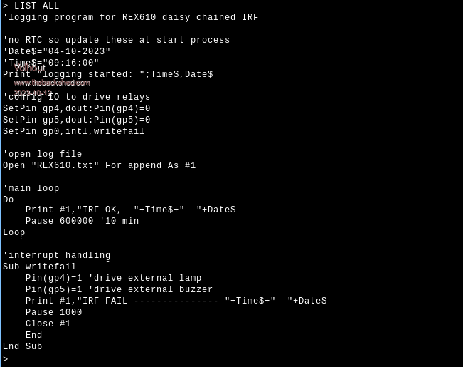

Sorry for the late reply. I run Ubuntu 20.04 (same core as Mint 20.03).
1/ In direct answer to your question above. See below pictures. The listing on the MMCC screen is identical to the program as typed in the build in editor. When sending the listing to MMEdit, empty lines are lost. And (not visible in this listing) formatted comments on the same line as the command/function are loosing TAB's or <SPACE>'s between command and comment.
MMCC
MMEDIT
2/ In Linux: When using MMEdit and MMCC it is essential that MMEdit is STARTING the MMCC program. This is typically happening when opening MMEdit and sending the program to the mite. MMEdit starts MMCC, MMCC transfers the program to the mite.
The combination MMCC and MMEdit do not work in any other order. So when I start MMCC and want to send to the editor, MMCC does not open MMEdit.
When I open MMCC, realize I want to sent to the editor, and manually open MMEdit, then MMCC cannot find MMEdit to send the listing to.
Picture this: I have a (i.e. micro-)mite with build in program, and I want to update the program. The only way to use MMEdit/MMCC is opening MMEdit, and let it open MMCC. But I need to leave the program in the mite intact....
The work around is to use teraterm/putty, and grab the listing from the mite (LIST ALL), then <ctrl-A><ctrl-C>. Store than on the PC, then open the program in MMEdit.
3/ In Linux version 5.2.1: I have observed 2 times that with multiple tabs open, it happens when closing 1 tab, text is moved into another tab. Example: I have a tab open "untitled" with the default startup lines in them. I open a second program "test.bas", that ends up in a second tab "test". I have seen 2 times that when I close "test", that the program test moves to the tab "untitled". This happens during editing sessions that include multipe uploads to the mite, and copy paste actions. So it is not easy to reproduce this.
Jim...please understand..MMEdit is a terrific tool, and these observations do not prevent me in any way using it. If you can fix them... nice.

I am having trouble seeing the issue here.
The problem when you close tabs was very much a problem with V5.2.0 but I thought it was fixed in 5.2.1
I have done some more work in that area so hopefully I have fixed it properly in 5.2.2 which I will try and send out in a day or two.
When you send from the micromite listing to the editor, a copy of the listing should be in your clipboard.
If you forget to open MMEdit before sending the listing, the copy will still be in the clipboard so you can then open the editor and a new tab then "paste" the listing. No need to go via another text editor.
Please try a "send listing to editor" and then open up your text editor and "paste" so we can see if the comment indenting is lost there.
In my image, I am using a WEBmite to connect with.
No lines or formatting are lost.
I also opened MMCC first, followed by MMEdit.
The issue might be related to a problem with TABs which I am working on. I have found that cause and nearly finished the code.
I also have a strange problem with highlighting user variables which has also been tracked down and the fix will be in the next release.
It might help if you send me a copy of MMEdit5.inf, just in case there is a setting I need to test.
