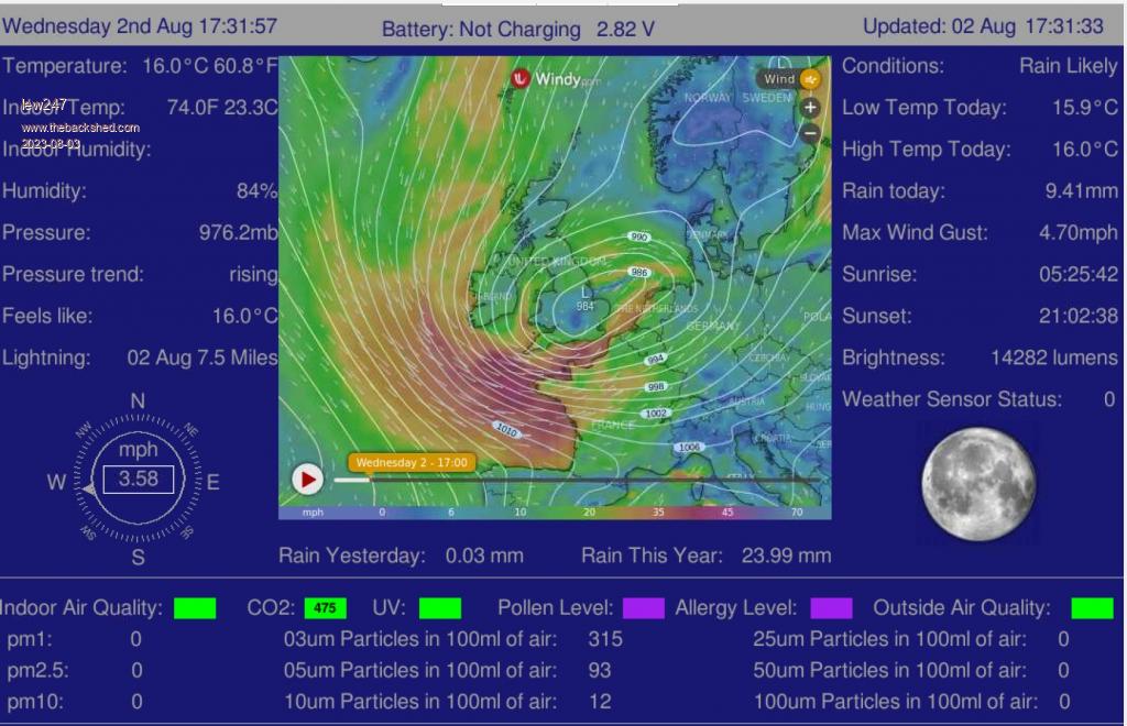

I have this problem
Indoor Humidity only flashes on the screen the goes off again
I know the sensor is working as the CO2 data is displaying

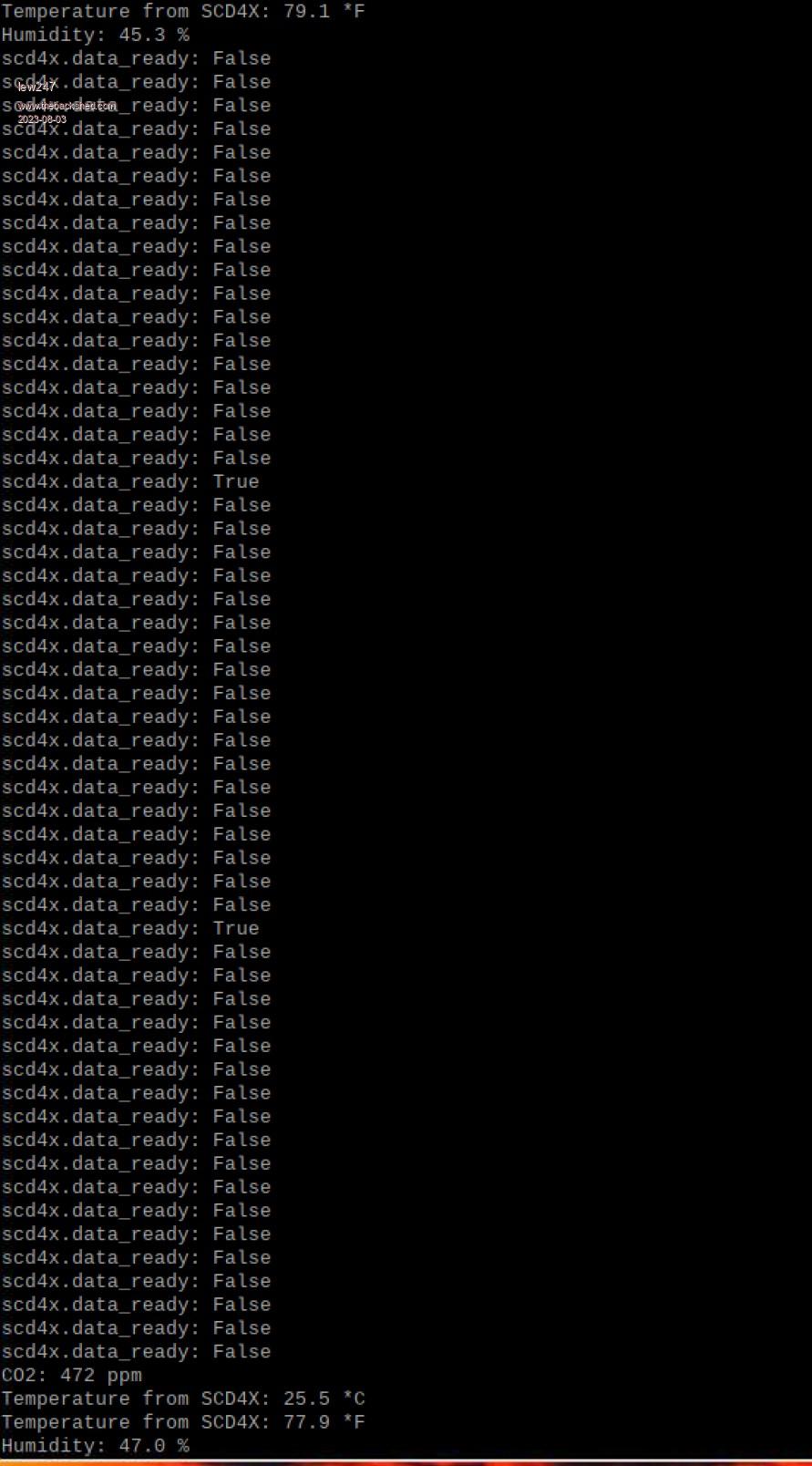

Here is the console output showing the result of print("scd4x.data_ready:", scd4x.data_ready)
How do I get the data to display on the screen but ignore the False, unless there is over 60 seconds of False then it might be a sensor issue
Basically I need a trigger to display the data when the data is true, start a timer ignore any False >= 60 seconds
If any True then the timer restarts
I have spent a total of maybe 18 hours now trying different ways of doing this and even ChatGpt can't help with this because it tried to get me to use a "While True" loop which locks the Pi up
I can't use While True
any suggestions?

Use the python timer function.
My python is to rusty to give you exact code, but:
from:
https://www.learndatasci.com/solutions/python-timer/
import time
start_time = time.time()
# The thing to time. Using sleep as an example
time.sleep(10)
end_time = time.time()
elapsed_time = end_time - start_time
print(elapsed_time)
does most of what you want.
Your code:
# remember my python is rusty, so something like:
  if scd4x.data_ready: and time.time() - start_time == however long you want
      HumidityScd = scd4x.relative_humidity

      # set the timer running here, i.e. on the first true value. If you want it to be from before, then you will need to set the timeer before you start the readings.
so:
start the timer / restart the timer every time you have a true reading that's the    start_time = time.time()  line. This will mean that things might not stabilise until you get the first true reading. If you want to be 100% then start the timer when you first run the program as well.
At the top of your routing add and and clause that subtrascts the stored start time from the current time, and if it is greater than whatever limit you want you can then clear the value screen otherwise the previous true reading will be left there.
Hope my Python memory is working !
Andy
Posts: 4405
Posted: 05:32pm 02 Aug 2023
EDIT: cross-posted with Andy, whose solution looks similar.
Something like this Lewis - you'll need to change it into valid Python:
    # What time will it be 1 minute from now ?
    HumidityTimer = datetime.now() + datetime.timedelta(minutes=1)
else if datetime.now() > humidity_timer:
    # Only "clear" if we are 1 minute from the last time the data was ready.
    HumidityScd = -1 # Data not ready.
Edited 2023-08-03 03:33 by thwill
