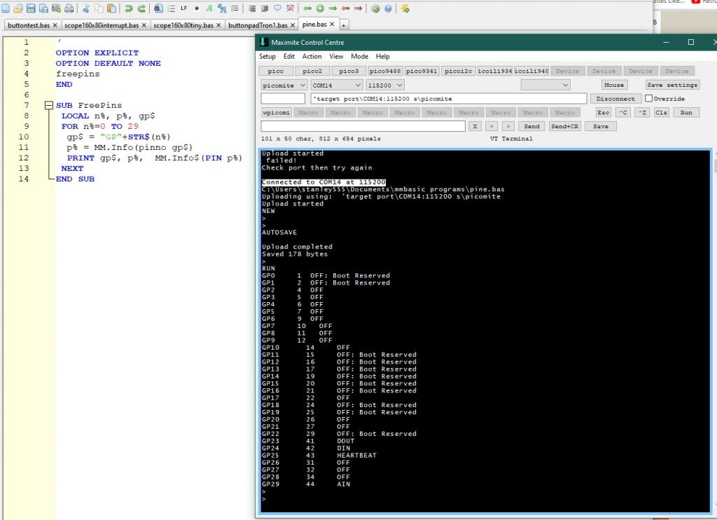

Posted: 08:30am 28 Jul 2023
Something for the library?
LIST
Sub FreePins
 For n=0 To 29
  gp$ = "GP"+Str$(n)
  p = MM.Info(pinno gp$)
  pu$ = MM.Info(pin p)
  Print gp$, p,  pu$
 Next
End Sub
> freepins
GP0      1      OFF
GP1      2      OFF
GP2      4      OFF
GP3      5      OFF
GP4      6      OFF
GP5      7      OFF
GP6      9      OFF
GP7      10     OFF
GP8      11     OFF
GP9      12     OFF
GP10     14     OFF
GP11     15     OFF
GP12     16     OFF
GP13     17     OFF
GP14     19     OFF
GP15     20     OFF
GP16     21     OFF
GP17     22     OFF
GP18     24     OFF
GP19     25     OFF
GP20     26     OFF
GP21     27     OFF
GP22     29     OFF
GP23     41     DOUT
GP24     42     DIN
GP25     43     HEARTBEAT
GP26     31     OFF
GP27     32     OFF
GP28     34     OFF
GP29     44     AIN

Sub FreePins
 local n%, p%, gp$
 For n%=0 To 29
  gp$ = "GP"+Str$(n%)
  p% = MM.Info(pinno gp$)
  Print gp$, p%,  MM.Info$(pin p%)
 Next
End Sub
stanleyella
Joined: 25/06/2022
Posts: 2807
Posted: 01:39pm 28 Jul 2023
That's useful Phil99. cheers
