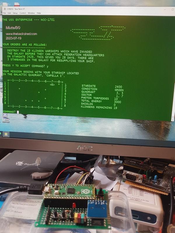

I found an RC2014 emulator for the Pico Here and couldn't resist. One of my PicoMites went over to the Dark Side and is now running Stephen Cousin's Small Computer Monitor and CP/M 2.2 with the aid of a microSD card. At the moment I'm using Tera Term to talk to it, but that's because it's easy and I haven't wired up the serial port yet. :) Maybe a photo in a bit, it's playtime.
The microSD card uses files to emulate floppy drives A to P.
You get the joys of running Grant Searle's adaptation of the old Nascom version of Microsoft BASIC from ROM or MBASIC (1977-1981 version) under CP/M - all with line numbery goodness!
Set Tera Term up for ancient green screen to get the true flavour. :)

Difficult to tell. Feels about right for a 4MHz - 8MHz Z80 to me so far. It's running over a 115200 baud serial link, of course. These things were never very fast. :)

I'm actually part way through converting that game to use in Mode 1 VGA on the PicoMite, with pretty graphics. It's one of "those" projects that gets picked up now and again. There have been versions of it for just about everything. :)
Getting text files (e.g. *.BAS) onto the RC2040 is ok, just cut & paste via Tera Term (but file size is limited and you have to use delays in Tera Term). Binaries are more difficult. I've not tested it yet, but there is a DOWNLOAD.COM program on drive A: and Grant Searle did a program to convert binary files into a compatible form to use it. Hopefully I won't need to edit any disk image files as it looks difficult to me.
The usual transient commands are provided on drive C: and there are some programs (including Startrek) on drive D:. I know I can save MBASIC programs to drive B: 'cos I've done it. :) A 64GB microSD card gives you drives A: to G:. A 128GB card gives you up to P:. In both cases the last drive is smaller than the others.
Very Important!
This had me head scratching. When you are creating the microSD card make sure you read the Readme file! I didn't put all the necessary files on it and I was getting errors. Oh, and get the MISO and MOSI connections right way round on your breadboard....  :)

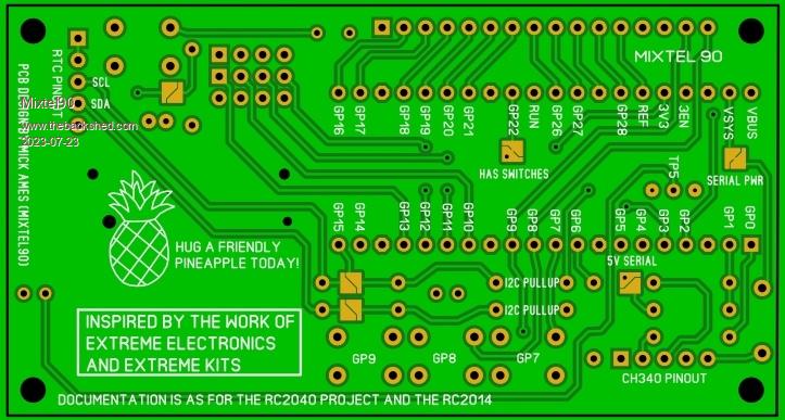

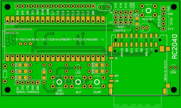

Would anyone like a PCB design for this little board? I could do one with a standard size SDcard socket to make soldering easier.
