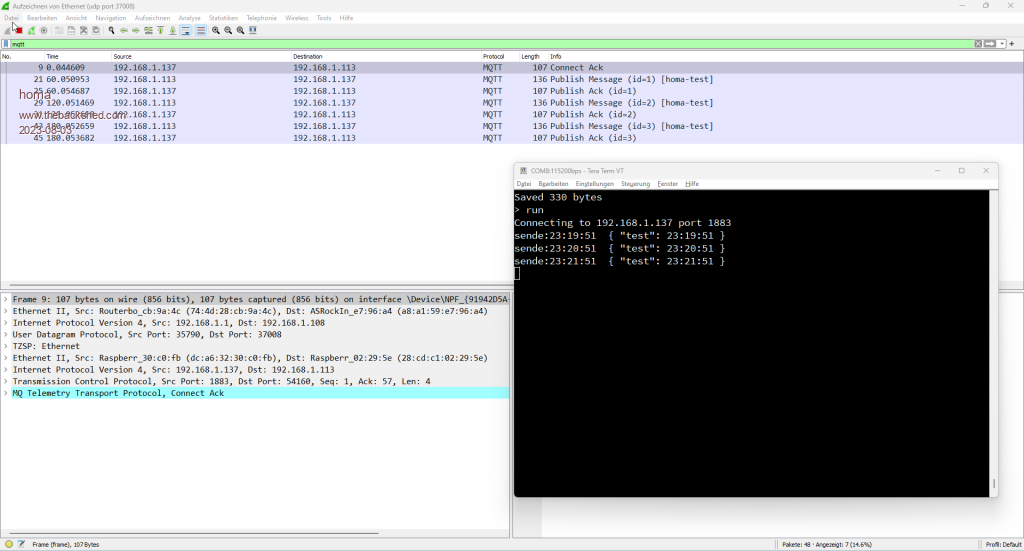

Unfortunately I don't see this in Wireshark!

At 60 seconds, everything looks good ...

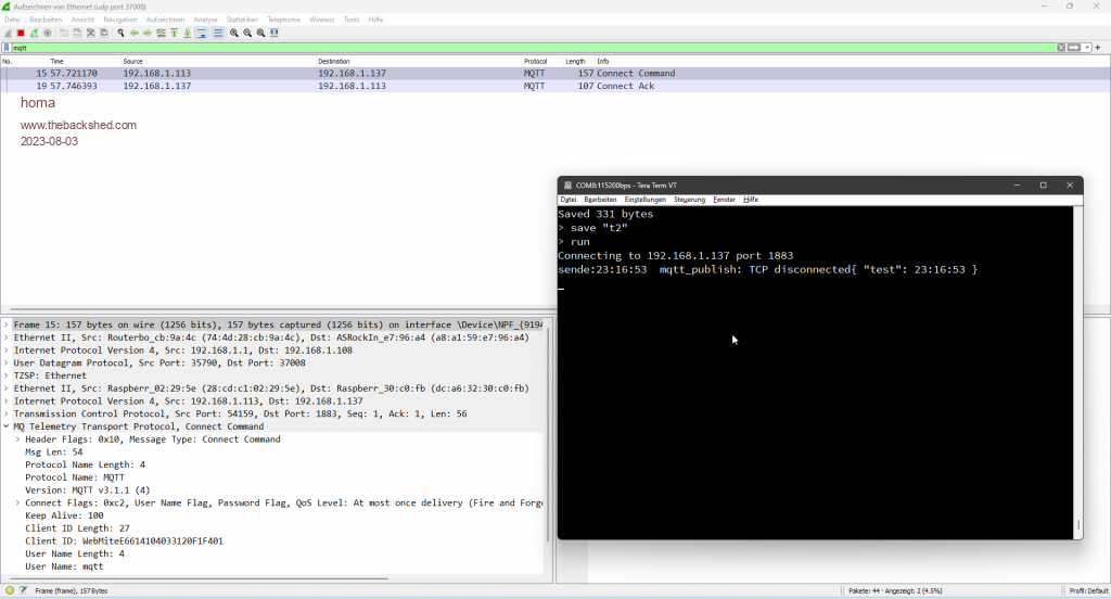

I don't see a keep-alive signal after 180 seconds ... Instead, the system tells me that the connection has been closed.

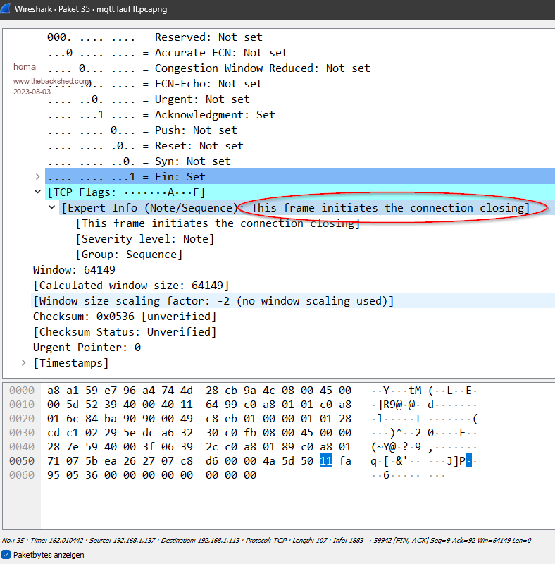

Hi Peter,
I have now recorded a complete test run without the MQTT filter.
It seems that the Keep-Alive is not recognised as an MQTT protocol by Wireshark, but only as a TCP protocol.
So you are right!
But this must be faulty
, because shortly afterwards the MQTT message comes out of the programme (10:42:52)! But this is rejected by the broker server.
The close/open helps in the running programme, as you can then see.
Matthias

31 20.556755 192.168.1.1 192.168.1.113 DHCP 389 DHCP ACK      - Transaction ID 0x9d96a37
32 20.556907 192.168.1.1 192.168.1.113 DHCP 389 DHCP ACK      - Transaction ID 0x9d96a37
33 29.016386 192.168.1.113 192.168.1.137 MQTT 136 Publish Message (id=2) [homa-test]
34 29.016551 192.168.1.113 192.168.1.137 TCP 136 [TCP Retransmission] 59939 → 1883 [PSH, ACK] Seq=91 Ack=9 Win=16376 Len=35
35 29.017519 192.168.1.137 192.168.1.113 MQTT 107 Publish Ack (id=2)
36 29.017689 192.168.1.137 192.168.1.113 MQTT 107 [TCP Fast Retransmission] , Publish Ack (id=2)
37 29.231347 192.168.1.113 192.168.1.137 TCP 101 59939 → 1883 [ACK] Seq=126 Ack=13 Win=16372 Len=0
38 29.231498 192.168.1.113 192.168.1.137 TCP 101 [TCP Dup ACK 37#1] 59939 → 1883 [ACK] Seq=126 Ack=13 Win=16372 Len=0
39 88.017191 192.168.1.113 192.168.1.137 MQTT 136 Publish Message (id=3) [homa-test]
40 88.017354 192.168.1.113 192.168.1.137 TCP 136 [TCP Retransmission] 59939 → 1883 [PSH, ACK] Seq=126 Ack=13 Win=16372 Len=35
41 88.018338 192.168.1.137 192.168.1.113 MQTT 107 Publish Ack (id=3)
42 88.018503 192.168.1.137 192.168.1.113 TCP 107 [TCP Retransmission] 1883 → 59939 [PSH, ACK] Seq=13 Ack=161 Win=64080 Len=4
43 88.231058 192.168.1.113 192.168.1.137 TCP 101 59939 → 1883 [ACK] Seq=161 Ack=17 Win=16368 Len=0
44 88.231099 192.168.1.113 192.168.1.137 TCP 101 [TCP Dup ACK 43#1] 59939 → 1883 [ACK] Seq=161 Ack=17 Win=16368 Len=0
53 177.018982 192.168.1.113 192.168.1.137 MQTT 136 Publish Message (id=4) [homa-test]
54 177.019138 192.168.1.113 192.168.1.137 TCP 136 [TCP Retransmission] 59939 → 1883 [PSH, ACK] Seq=161 Ack=17 Win=16368 Len=35
55 177.020070 192.168.1.137 192.168.1.113 MQTT 107 Publish Ack (id=4)
56 177.020225 192.168.1.137 192.168.1.113 TCP 107 [TCP Retransmission] 1883 → 59939 [PSH, ACK] Seq=17 Ack=196 Win=64045 Len=4
57 177.232744 192.168.1.113 192.168.1.137 TCP 101 59939 → 1883 [ACK] Seq=196 Ack=21 Win=16364 Len=0
58 177.232744 192.168.1.113 192.168.1.137 TCP 101 [TCP Dup ACK 57#1] 59939 → 1883 [ACK] Seq=196 Ack=21 Win=16364 Len=0
67 320.562070 192.168.1.113 192.168.1.1 DHCP 397 DHCP Request  - Transaction ID 0x9d96a37
68 320.562248 192.168.1.113 192.168.1.1 DHCP 397 DHCP Request  - Transaction ID 0x9d96a37
69 320.562420 192.168.1.1 192.168.1.113 DHCP 389 DHCP ACK      - Transaction ID 0x9d96a37
70 320.562578 192.168.1.1 192.168.1.113 DHCP 389 DHCP ACK      - Transaction ID 0x9d96a37
71 331.026991 192.168.1.137 192.168.1.113 TCP 107 1883 → 59939 [FIN, ACK] Seq=21 Ack=196 Win=64045 Len=0
72 331.027165 192.168.1.137 192.168.1.113 TCP 107 [TCP Retransmission] 1883 → 59939 [FIN, ACK] Seq=21 Ack=196 Win=64045 Len=0
73 331.029429 192.168.1.113 192.168.1.137 TCP 101 59939 → 1883 [FIN, ACK] Seq=196 Ack=22 Win=16363 Len=0
74 331.029429 192.168.1.113 192.168.1.137 TCP 101 [TCP Retransmission] 59939 → 1883 [FIN, ACK] Seq=196 Ack=22 Win=16363 Len=0
75 331.029567 192.168.1.137 192.168.1.113 TCP 107 1883 → 59939 [ACK] Seq=22 Ack=197 Win=64045 Len=0
76 331.029729 192.168.1.137 192.168.1.113 TCP 107 [TCP Dup ACK 75#1] 1883 → 59939 [ACK] Seq=22 Ack=197 Win=64045 Len=0
77 374.021318 192.168.1.113 192.168.1.137 TCP 105 59940 → 1883 [SYN] Seq=0 Win=16384 Len=0 MSS=1460
78 374.021681 192.168.1.113 192.168.1.137 TCP 105 [TCP Retransmission] 59940 → 1883 [SYN] Seq=0 Win=16384 Len=0 MSS=1460
79 374.021927 192.168.1.137 192.168.1.113 TCP 107 1883 → 59940 [SYN, ACK] Seq=0 Ack=1 Win=64240 Len=0 MSS=1460
80 374.022082 192.168.1.137 192.168.1.113 TCP 107 [TCP Retransmission] 1883 → 59940 [SYN, ACK] Seq=0 Ack=1 Win=64240 Len=0 MSS=1460
81 374.023621 192.168.1.113 192.168.1.137 MQTT 156 Connect Command
82 374.024000 192.168.1.113 192.168.1.137 TCP 156 [TCP Retransmission] 59940 → 1883 [PSH, ACK] Seq=1 Ack=1 Win=16384 Len=55
83 374.024171 192.168.1.137 192.168.1.113 TCP 107 1883 → 59940 [ACK] Seq=1 Ack=56 Win=64185 Len=0
84 374.024334 192.168.1.137 192.168.1.113 TCP 107 [TCP Dup ACK 83#1] 1883 → 59940 [ACK] Seq=1 Ack=56 Win=64185 Len=0
85 374.046228 192.168.1.137 192.168.1.113 MQTT 107 Connect Ack
86 374.046419 192.168.1.137 192.168.1.113 TCP 107 [TCP Retransmission] 1883 → 59940 [PSH, ACK] Seq=1 Ack=56 Win=64185 Len=4
87 374.061582 192.168.1.113 192.168.1.137 MQTT 136 Publish Message (id=1) [homa-test]
88 374.061755 192.168.1.113 192.168.1.137 TCP 136 [TCP Retransmission] 59940 → 1883 [PSH, ACK] Seq=56 Ack=5 Win=16380 Len=35
89 374.061916 192.168.1.137 192.168.1.113 MQTT 107 Publish Ack (id=1)
90 374.062077 192.168.1.137 192.168.1.113 TCP 107 [TCP Retransmission] 1883 → 59940 [PSH, ACK] Seq=5 Ack=91 Win=64150 Len=4
91 374.261228 192.168.1.137 192.168.1.113 TCP 107 [TCP Retransmission] 1883 → 59940 [PSH, ACK] Seq=5 Ack=91 Win=64150 Len=4
92 374.262083 192.168.1.137 192.168.1.113 TCP 107 [TCP Retransmission] 1883 → 59940 [PSH, ACK] Seq=5 Ack=91 Win=64150 Len=4
93 374.265566 192.168.1.113 192.168.1.137 TCP 101 59940 → 1883 [ACK] Seq=91 Ack=9 Win=16376 Len=0
94 374.265650 192.168.1.113 192.168.1.137 TCP 101 [TCP Dup ACK 93#1] 59940 → 1883 [ACK] Seq=91 Ack=9 Win=16376 Len=0
103 383.022694 192.168.1.113 192.168.1.137 MQTT 136 Publish Message (id=2) [homa-test]
104 383.022866 192.168.1.113 192.168.1.137 TCP 136 [TCP Retransmission] 59940 → 1883 [PSH, ACK] Seq=91 Ack=9 Win=16376 Len=35
105 383.023701 192.168.1.137 192.168.1.113 MQTT 107 Publish Ack (id=2)
106 383.023867 192.168.1.137 192.168.1.113 TCP 107 [TCP Retransmission] 1883 → 59940 [PSH, ACK] Seq=9 Ack=126 Win=64115 Len=4
107 383.270973 192.168.1.113 192.168.1.137 TCP 101 59940 → 1883 [ACK] Seq=126 Ack=13 Win=16372 Len=0
108 383.271124 192.168.1.113 192.168.1.137 TCP 101 [TCP Dup ACK 107#1] 59940 → 1883 [ACK] Seq=126 Ack=13 Win=16372 Len=0
109 392.023841 192.168.1.113 192.168.1.137 MQTT 136 Publish Message (id=3) [homa-test]
110 392.023995 192.168.1.113 192.168.1.137 TCP 136 [TCP Retransmission] 59940 → 1883 [PSH, ACK] Seq=126 Ack=13 Win=16372 Len=35
111 392.024825 192.168.1.137 192.168.1.113 MQTT 107 Publish Ack (id=3)
112 392.024979 192.168.1.137 192.168.1.113 TCP 107 [TCP Retransmission] 1883 → 59940 [PSH, ACK] Seq=13 Ack=161 Win=64080 Len=4
113 392.271140 192.168.1.113 192.168.1.137 TCP 101 59940 → 1883 [ACK] Seq=161 Ack=17 Win=16368 Len=0
114 392.271313 192.168.1.113 192.168.1.137 TCP 101 [TCP Dup ACK 113#1] 59940 → 1883 [ACK] Seq=161 Ack=17 Win=16368 Len=0
115 401.022865 192.168.1.113 192.168.1.137 MQTT 136 Publish Message (id=4) [homa-test]
116 401.023011 192.168.1.113 192.168.1.137 TCP 136 [TCP Retransmission] 59940 → 1883 [PSH, ACK] Seq=161 Ack=17 Win=16368 Len=35
117 401.023973 192.168.1.137 192.168.1.113 MQTT 107 Publish Ack (id=4)
118 401.024136 192.168.1.137 192.168.1.113 TCP 107 [TCP Retransmission] 1883 → 59940 [PSH, ACK] Seq=17 Ack=196 Win=64045 Len=4
119 401.271304 192.168.1.113 192.168.1.137 TCP 101 59940 → 1883 [ACK] Seq=196 Ack=21 Win=16364 Len=0
120 401.271501 192.168.1.113 192.168.1.137 TCP 101 [TCP Dup ACK 119#1] 59940 → 1883 [ACK] Seq=196 Ack=21 Win=16364 Len=0

*Addendum:
I just see that after the 150 seconds the connection from the server (192.168.1.137) to the client (.113) is established! Is it possible that this is the disconnect message? (YES! see screenshot.) Then PINGREQ/PINGRESP would definitely be missing in beta10.
(1)
1 0.000000 192.168.1.113 192.168.1.137 TCP 101 59941 → 1883 [FIN, ACK] Seq=1 Ack=1 Win=16376 Len=0
2 0.000000 192.168.1.113 192.168.1.137 TCP 101 [TCP Retransmission] 59941 → 1883 [FIN, ACK] Seq=1 Ack=1 Win=16376 Len=0
3 0.000618 192.168.1.137 192.168.1.113 TCP 107 1883 → 59941 [FIN, ACK] Seq=1 Ack=2 Win=64148 Len=0
4 0.000748 192.168.1.137 192.168.1.113 TCP 107 [TCP Retransmission] 1883 → 59941 [FIN, ACK] Seq=1 Ack=2 Win=64148 Len=0
5 0.002740 192.168.1.113 192.168.1.137 TCP 105 59942 → 1883 [SYN] Seq=0 Win=16384 Len=0 MSS=1460
6 0.003069 192.168.1.113 192.168.1.137 TCP 105 [TCP Retransmission] 59942 → 1883 [SYN] Seq=0 Win=16384 Len=0 MSS=1460
7 0.003293 192.168.1.137 192.168.1.113 TCP 107 1883 → 59942 [SYN, ACK] Seq=0 Ack=1 Win=64240 Len=0 MSS=1460
8 0.003440 192.168.1.137 192.168.1.113 TCP 107 [TCP Retransmission] 1883 → 59942 [SYN, ACK] Seq=0 Ack=1 Win=64240 Len=0 MSS=1460
9 0.009186 192.168.1.113 192.168.1.137 TCP 101 59941 → 1883 [ACK] Seq=2 Ack=2 Win=16375 Len=0
10 0.009546 192.168.1.113 192.168.1.137 TCP 101 [TCP Dup ACK 9#1] 59941 → 1883 [ACK] Seq=2 Ack=2 Win=16375 Len=0
11 0.009935 192.168.1.113 192.168.1.137 MQTT 157 Connect Command
12 0.010139 192.168.1.113 192.168.1.137 TCP 157 [TCP Retransmission] 59942 → 1883 [PSH, ACK] Seq=1 Ack=1 Win=16384 Len=56
13 0.010310 192.168.1.137 192.168.1.113 TCP 107 1883 → 59942 [ACK] Seq=1 Ack=57 Win=64184 Len=0
14 0.010439 192.168.1.137 192.168.1.113 TCP 107 [TCP Dup ACK 13#1] 1883 → 59942 [ACK] Seq=1 Ack=57 Win=64184 Len=0
15 0.010960 192.168.1.137 192.168.1.113 MQTT 107 Connect Ack
16 0.011126 192.168.1.137 192.168.1.113 TCP 107 [TCP Retransmission] 1883 → 59942 [PSH, ACK] Seq=1 Ack=57 Win=64184 Len=4
17 0.237845 192.168.1.137 192.168.1.113 TCP 107 [TCP Retransmission] 1883 → 59942 [PSH, ACK] Seq=1 Ack=57 Win=64184 Len=4
18 0.237845 192.168.1.137 192.168.1.113 TCP 107 [TCP Retransmission] 1883 → 59942 [PSH, ACK] Seq=1 Ack=57 Win=64184 Len=4
19 0.239745 192.168.1.113 192.168.1.137 TCP 101 59942 → 1883 [ACK] Seq=57 Ack=5 Win=16380 Len=0
20 0.239745 192.168.1.113 192.168.1.137 TCP 101 [TCP Dup ACK 19#1] 59942 → 1883 [ACK] Seq=57 Ack=5 Win=16380 Len=0
(2)
21 10.016971 192.168.1.113 192.168.1.137 MQTT 136 Publish Message (id=1) [homa-test]
22 10.017126 192.168.1.113 192.168.1.137 TCP 136 [TCP Retransmission] 59942 → 1883 [PSH, ACK] Seq=57 Ack=5 Win=16380 Len=35
23 10.020780 192.168.1.137 192.168.1.113 MQTT 107 Publish Ack (id=1)
24 10.020944 192.168.1.137 192.168.1.113 TCP 107 [TCP Retransmission] 1883 → 59942 [PSH, ACK] Seq=5 Ack=92 Win=64149 Len=4
25 10.258225 192.168.1.113 192.168.1.137 TCP 101 59942 → 1883 [ACK] Seq=92 Ack=9 Win=16376 Len=0
26 10.258369 192.168.1.113 192.168.1.137 TCP 101 [TCP Dup ACK 25#1] 59942 → 1883 [ACK] Seq=92 Ack=9 Win=16376 Len=0
(3)
35 162.010442 192.168.1.137 192.168.1.113 TCP 107 1883 → 59942 [FIN, ACK] Seq=9 Ack=92 Win=64149 Len=0
36 162.010644 192.168.1.137 192.168.1.113 TCP 107 [TCP Retransmission] 1883 → 59942 [FIN, ACK] Seq=9 Ack=92 Win=64149 Len=0
37 162.012541 192.168.1.113 192.168.1.137 TCP 101 59942 → 1883 [FIN, ACK] Seq=92 Ack=10 Win=16375 Len=0
38 162.012616 192.168.1.113 192.168.1.137 TCP 101 [TCP Retransmission] 59942 → 1883 [FIN, ACK] Seq=92 Ack=10 Win=16375 Len=0
39 162.012839 192.168.1.137 192.168.1.113 TCP 107 1883 → 59942 [ACK] Seq=10 Ack=93 Win=64148 Len=0
40 162.013073 192.168.1.137 192.168.1.113 TCP 107 [TCP Dup ACK 39#1] 1883 → 59942 [ACK] Seq=10 Ack=93 Win=64148 Len=0
(4)     ???
> run
Connecting to 192.168.1.137 port 1883               <== (1)
sende:12:47:49  { "test": 12:47:49 }                <== (2)
..........................................................................................<== (3) ......
sende:12:51:39  mqtt_publish: TCP disconnected{ "test": 12:51:39 }    <== (4 - nothing!)
